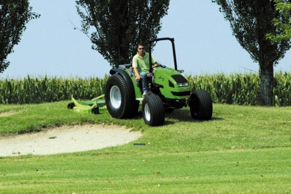

i don't agree with the ones who prefer the hydro transmission, i drive for a few years hydro's +-10 years, and all of them where NH's the last one a tc 45 da and now i have a tce 50 with the 16*16 syncho and i love it, after a few hours its like a automatism, and i love this tractor it is great only when i lived in the usa i would buy me a tc 45 da, but i think i would prefer the tc 48 da in that case.
The hydro is nice but a good transmission a as good as a hydro.
