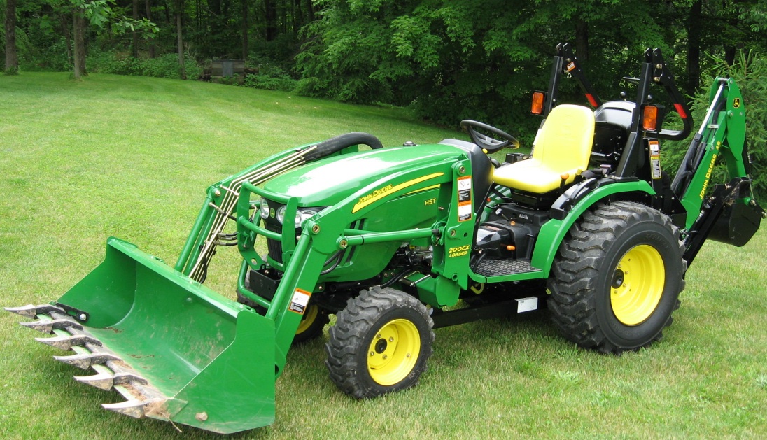

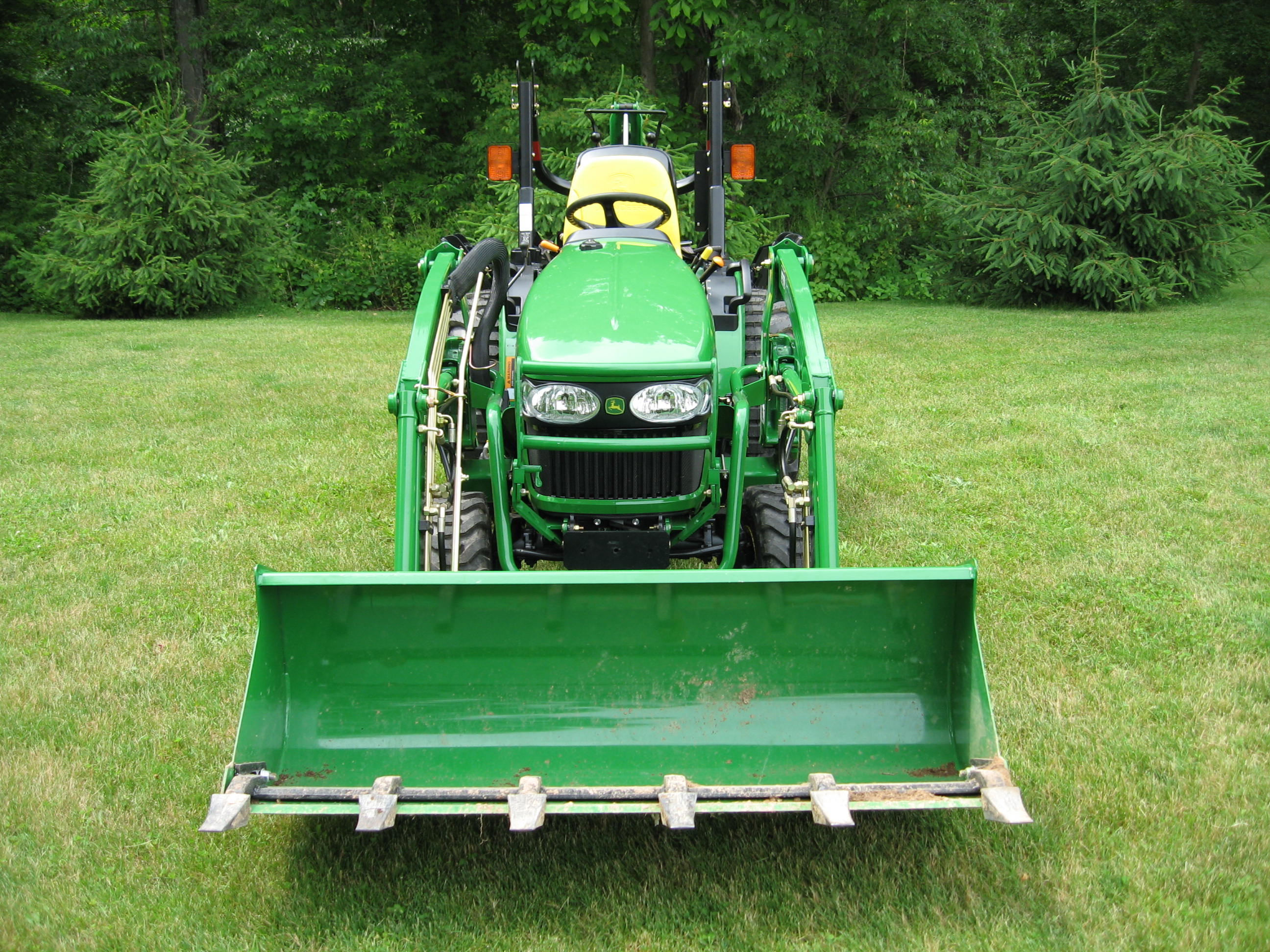

My 2520 has the JD toothbar (61") mounted on the bucket. The bolt is centered in the rearmost slot, when the toothbar is in place. It appears to be a 5/8" x 2" grade 8 bolt (probably metric) with a self-locking nut . This toothbar is the same for the 300/400 series loaders. Use some tapping oil on the drill after you've center punched the spot, most any ole oil will do in a pinch. I'll try to attach a photo.

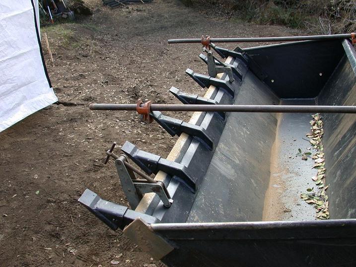

jmt1271,
A good way to ensure the toothbar is sitting as snug as possible on the edge of the bucket is to clamp it into position using furniture or pipe clamps and a couple of C clamps or K-Clamps. Then go about the drilling process as described.
