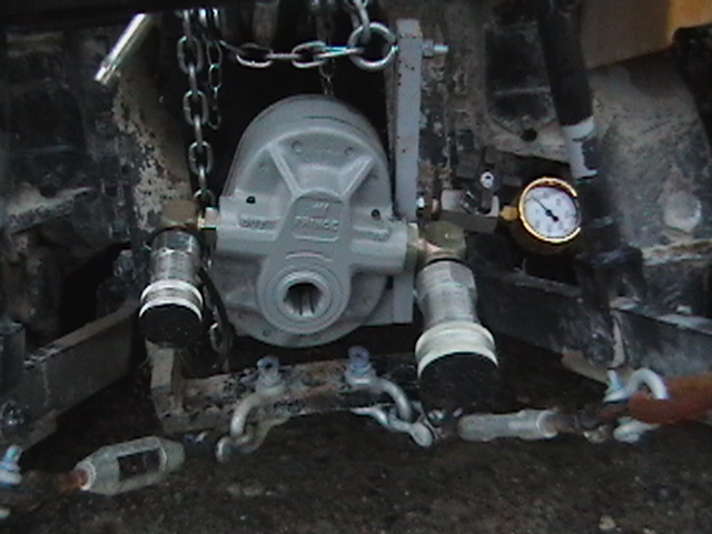

I had same/similar pump issues with my LW6 backhoe. I could find no good reason to keep blowing pump seals, so I finally bit the bullet and bought a Prince 7 gpm PTO pump. Wow! What a difference and no more problems.
