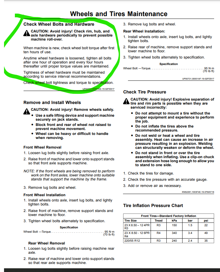

Have had my 4300 since '98 and read in the manual that I should check the wheel bolts (so my responsibility as regular maintenance). To help, I put a small black magic marker dot on each bolt front and rears. Watched them and after the first few months some had some looseness, but since then none have moved.
JD has no way of knowing if the owner reads the manual and checks their wheel bolts.
Sorry to hear of your wheel falling off and getting injured.
   / Loose wheel bolts #9
Exactly. When my 4105 was delivered I read the Owner Manual from cover to cover... twice. Initially and then periodically checking the torque (written in the Manual) of all the wheel nuts is listed. I immediately purchased a torque wrench and confirmed that my dealership had delivered the tractor 'in spec'.
My dealership had already performed the magic marker dot on each bolt. None of them have ever come loose in the years that I've had my tractor.
It's up to the owner to confirm and maintain. Vibration, due to use and the general running of a diesel engine, will loosen things over time.

I'm sorry you got injured & your tractor received damage. Good luck with your lawsuit against JD. It won't surprise me if JD attorney's don't point out the fact it states in operators manual to periodically check wheel bolt torque.
