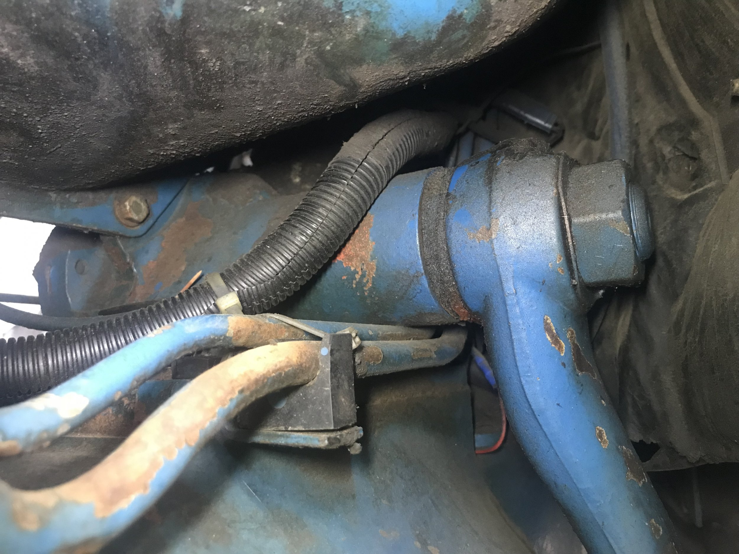

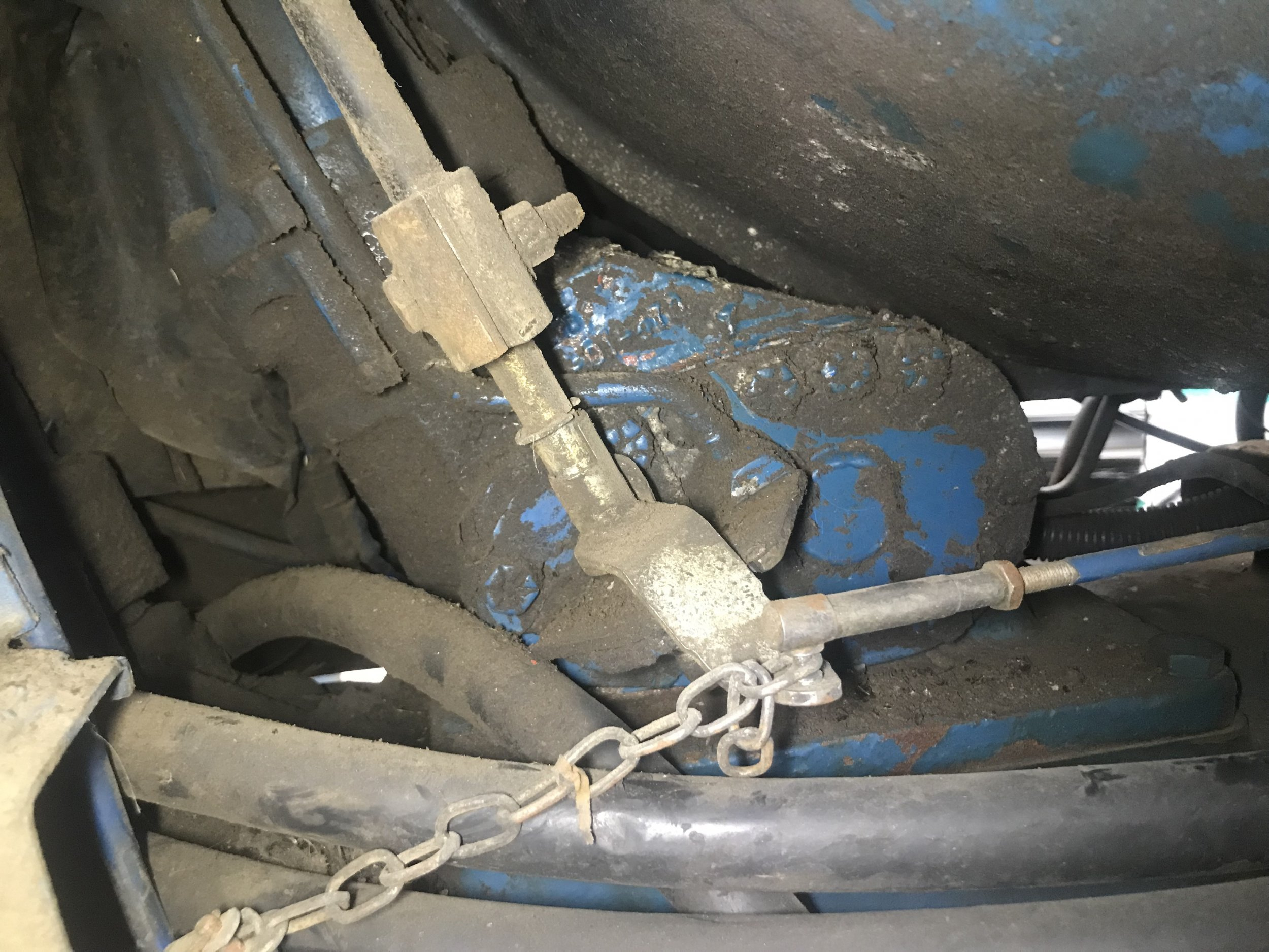

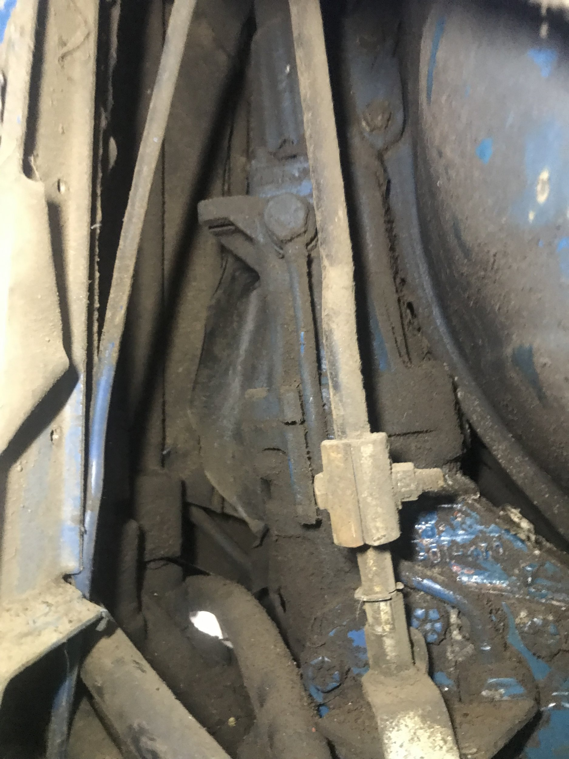

I seem to have a lot of play in the steering box (power steering)
Is there a way to adjust the gear in the steering box
   / Loose Steering #2
Usually you can adjust it some. Can you post some pictures of your steering box?
   / Loose Steering
Apologies for taking so long to reply Here are some photos of the steering box I hope they are good enough
   / Loose Steering #4
So what is in the center of this plate I circled? I am thinking there should be a jam nut on a screw with a slot in the end to adjust the sector shaft gear mesh.
   / Loose Steering
I thought so too but nothing like that to be seen. Is there anything under the steering box its the only place I could not see.
   / Loose Steering #6
There is no external adjustment screw on this box. There is nothing under it either. If you have play internally, there isn't much you can do from the outside. I wouldn't suggest tearing too deeply into it without the appropriate manual. (of course your choice there)
