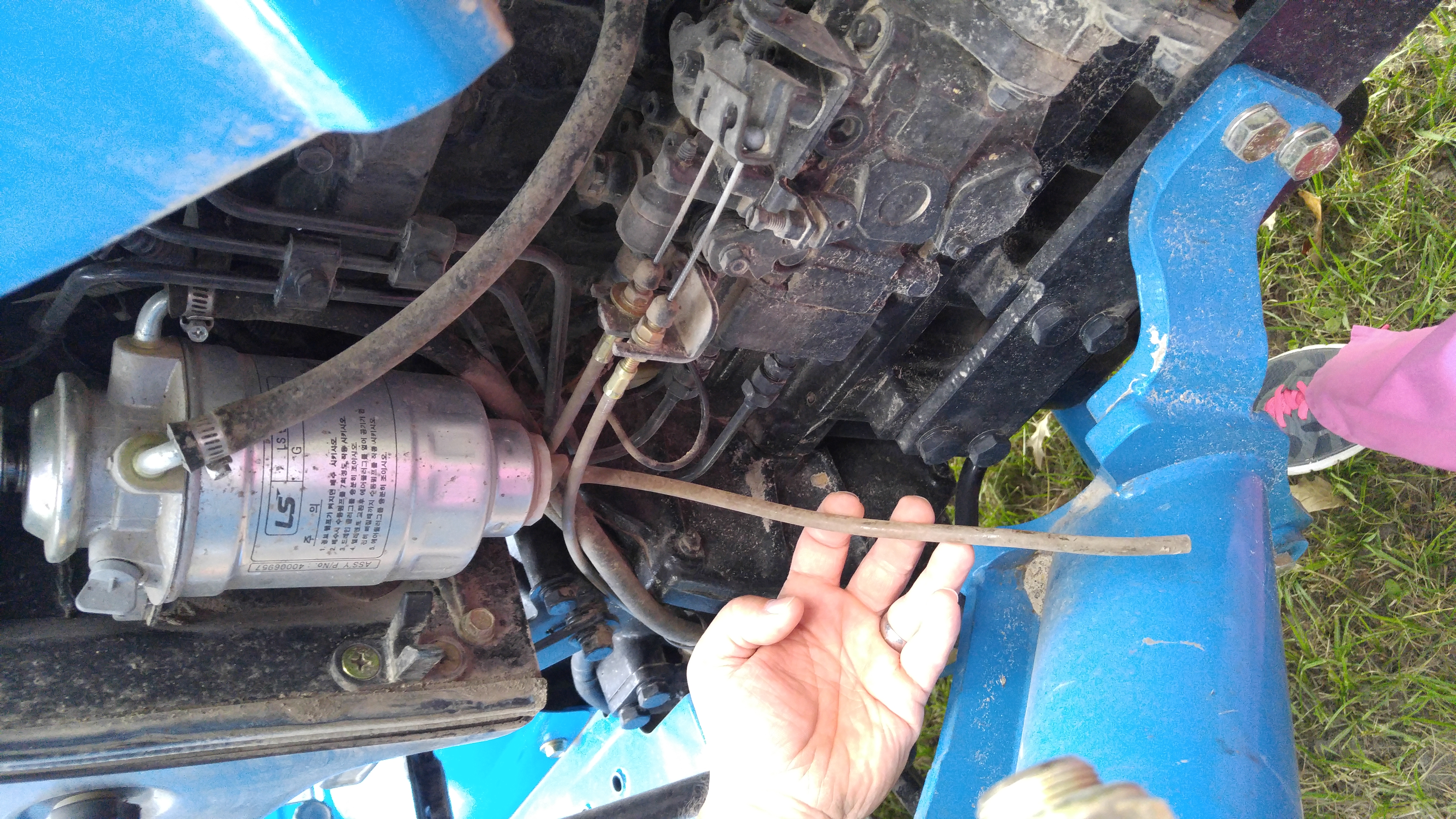

Sep 15, 2017 / Loose Hose #1 P Peterson3 New member Joined Sep 12, 2017 Messages 2 Location Coldspring, TX Tractor LS G3033 Hi ya'll, We had a hose come loose on our G3033 and we can't figue out where it's supposed to go. Does anyone have any idea where the other end of this goes? Thanks!
Sep 15, 2017 / Loose Hose #2 alexsbuddy Gold Member Joined Mar 10, 2016 Messages 332 Location Diamond, MO Tractor LS XG3037 w/ LS LL3109 FEL Kodiak SD5 Mower, Speeco Model 65 PHD, Bush Hog BX-600 Box Blade, Titan 42" Skid Steer Pallet Fork/Hay Spear Combo I think this is just a drain tube and the bottom end is left unattached.
Sep 15, 2017 / Loose Hose Thread Starter #3 OP P Peterson3 New member Joined Sep 12, 2017 Messages 2 Location Coldspring, TX Tractor LS G3033 Thanks
Sep 16, 2017 / Loose Hose #4 S Spanner Veteran Member Joined Jul 2, 2017 Messages 1,297 Location Auckland, NZ Tractor John Deere Have you read your Operators Manual? It's for the regular draining of water from your fuel filter (You do do that don't you?)
