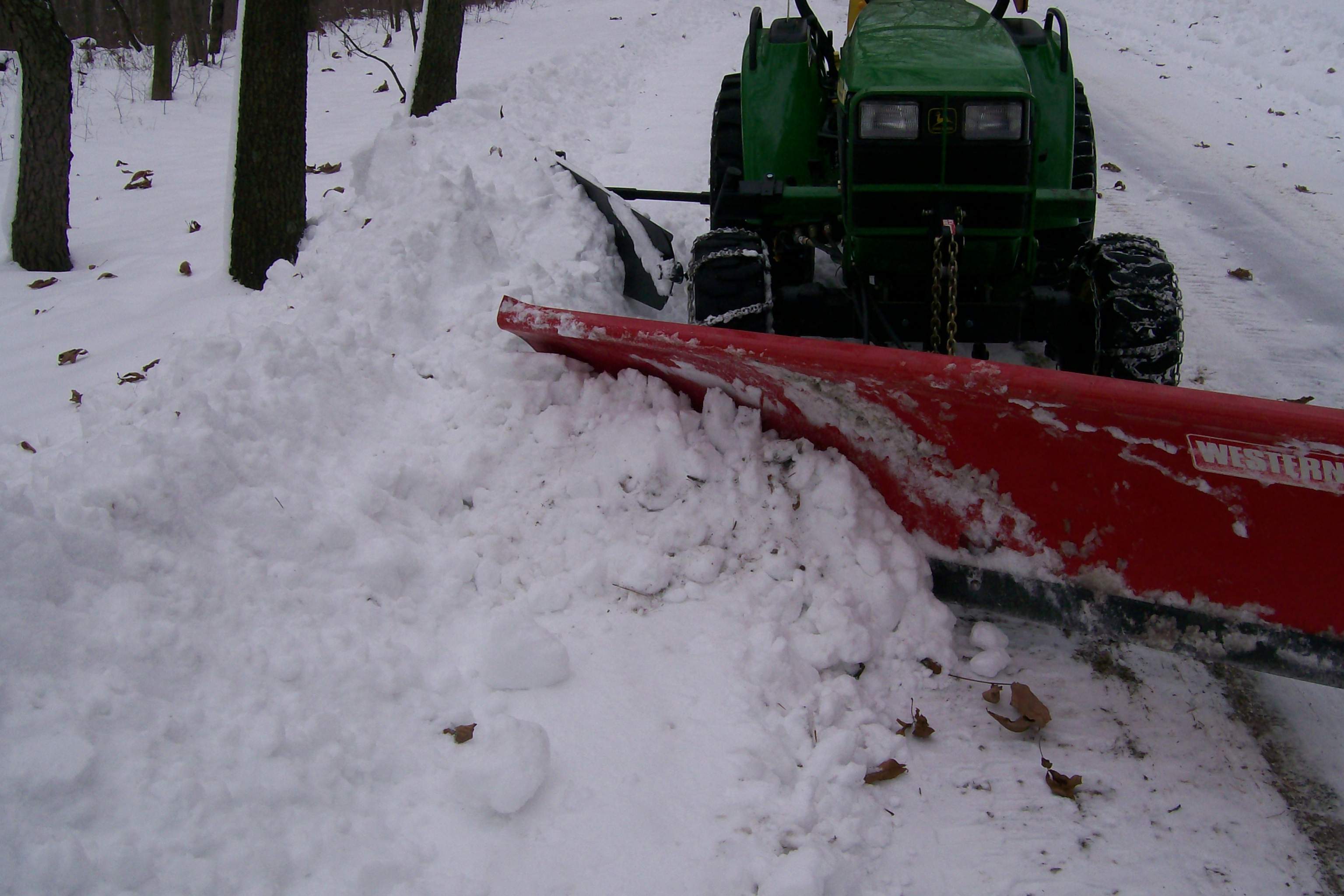

Wish you luck getting all the "wants" in one unit.
For the long drive, I'd suggest the cabbed 4720 with an 8' Western (or similar) plow attached to the frame (not the FEL) and a wing plow that will attach easily/quickly.
