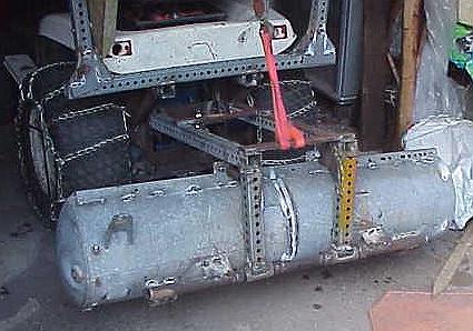

Made dis fer backing into garage doorway and pulling snow out. Originally 10 gallon well tank dat was on junque pile. Frame from another junque pile of run over road signs.
4 foot blade in 1 piece real easy you find unemployed water heater and cut. If you take ends out weld on reinforcement before end comes out. Job works easier dat way. Air compressor tank work too.

An old Water Heater tank is not a bad starting point, and materials would be cheap or free.
