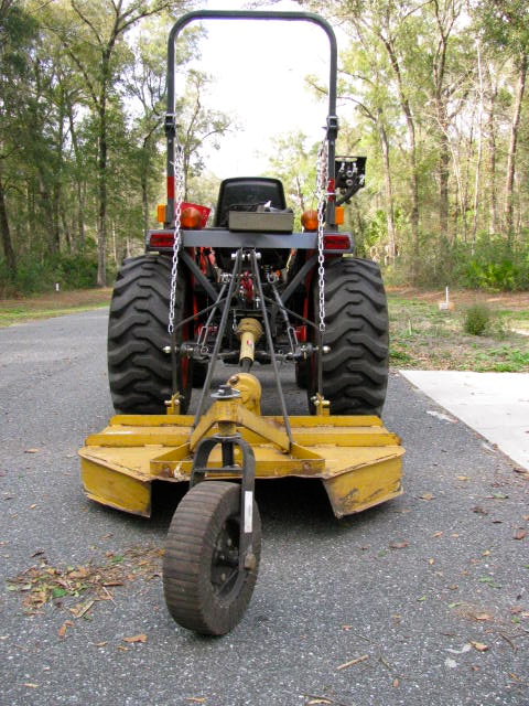

The smaller Bush Hogs/Rotary Cutters cut a 48" swath. You can pull a 48" Rotary Cutter with almost any small tractor that has a Category 1 Three Point Hitch. Subcompact tractors (< 20 engine horsepower) generally have 9" ground clearance which limits them somewhat. Compact tractors (20-40 engine horsepower) generally have 12"+ ground clearance which makes them more general purpose. Compact tractors can pull 60" and 72" Rotary Cutters.
Three Point Hitch LINK:
TractorData.com - Three-Point Hitch
It takes roughly five engine horsepower to power each 12" of RC width. Twenty HP = 48", Twenty-five HP = 60", Thirty HP = 72", etc.
