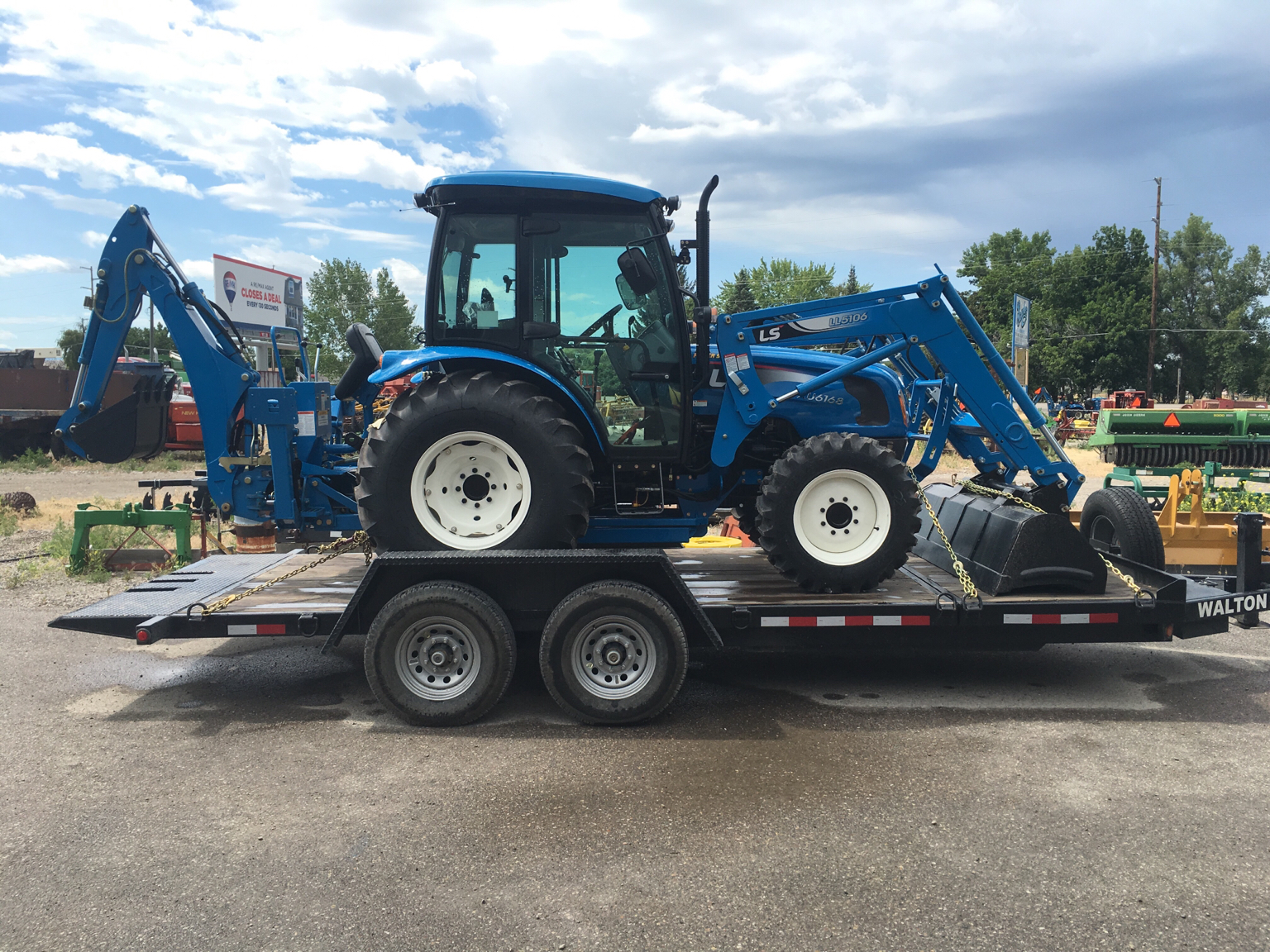

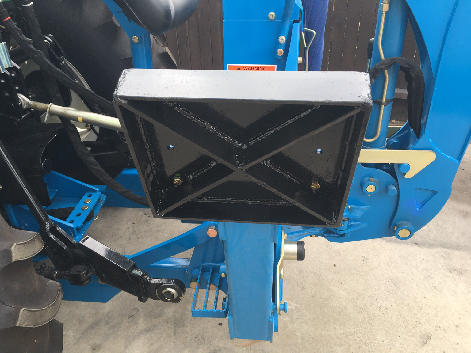

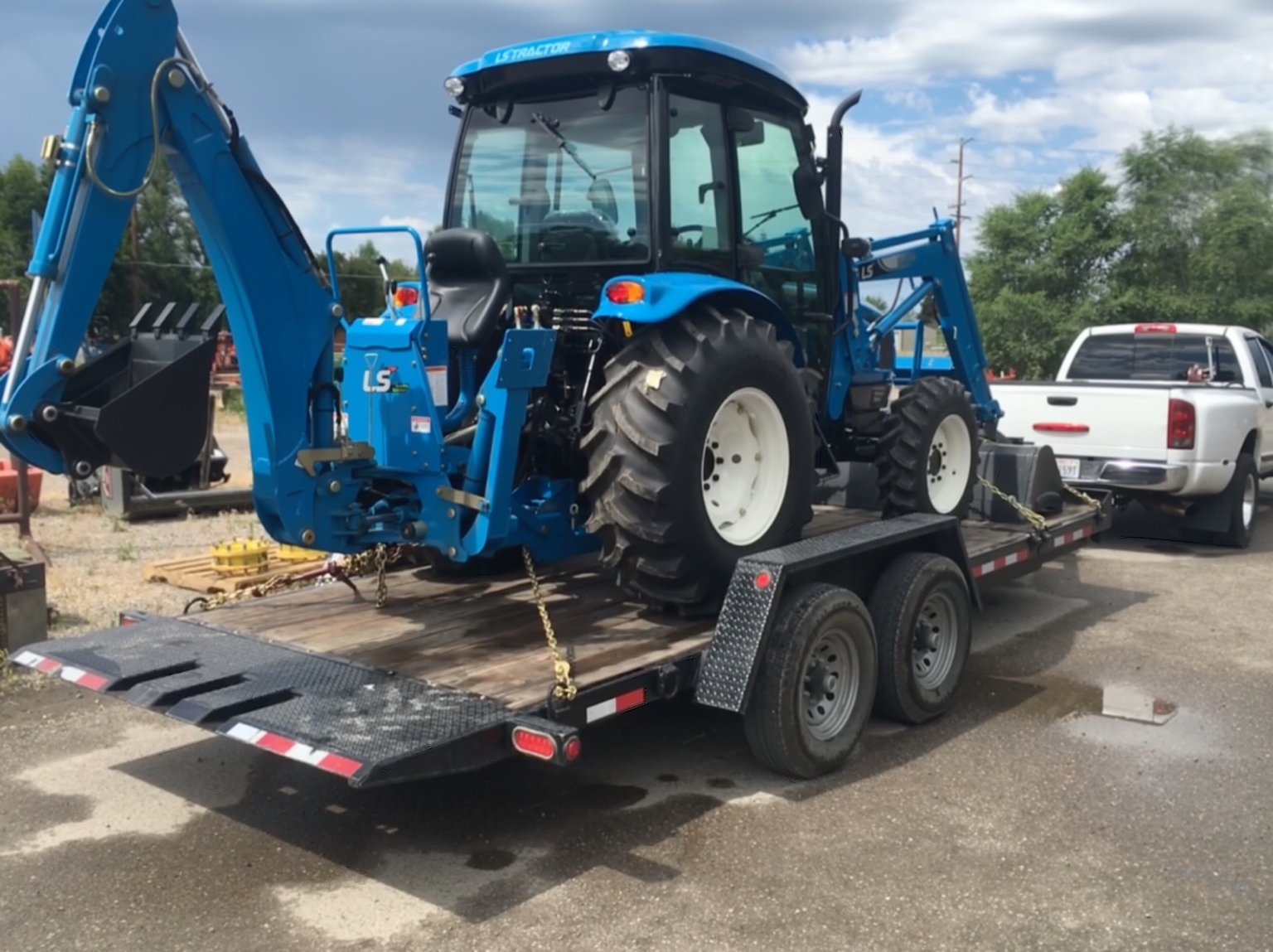

I was in the same boat last summer. I never saw the hoe in person before delivery. I special ordered and it only took two weeks for delivery. Came with third detented remote for the hoe, but no feet for the stabilizers. I had to make those and now it doesn’t move the whole tractor around.
Here she is on a 20ft tilt deck.
The home made stabilizer feet.

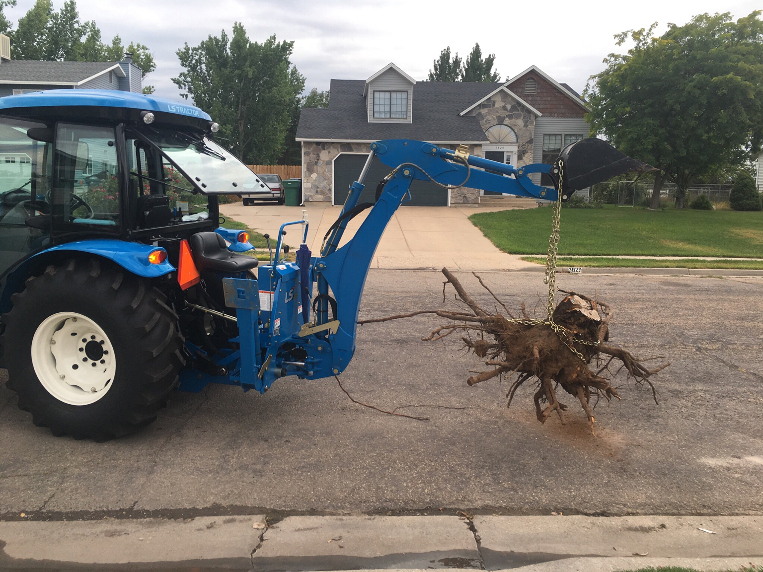

I have been adding on when there is something to report. So far, just scheduled maintenance to report.
Here’s a picture of a stump I dug out for a friend. Took like two minutes vs. like a days work by hand.

I plan on clearing and working on wetlands, do you think I need to buy or build anything for the feet? The backhoe will probably never come off, but what do I know? This is going to be my first and last tractor, so it is this or the little JD 4066M with their cheap loader and smaller hoe with it痴 shorter warranty. I must say I love everything I read about LS Tractors.
I was in the same boat last summer. I never saw the hoe in person before delivery. I special ordered and it only took two weeks for delivery. Came with third detented remote for the hoe, but no feet for the stabilizers. I had to make those and now it doesn稚 move the whole tractor around.

I like those shoes, I definitely think I need
   / Looking to buy XU6158 with LB3102 Backhoe, Any advise appreciated #6
Kioti dealers can order a shoe that looks like it will fit. Search for backhoe stabilizer pass in the Kioti forum. They are kind of spendy though , about $150 IIRC.
I made mine from 1/4” plate I had laying around.
