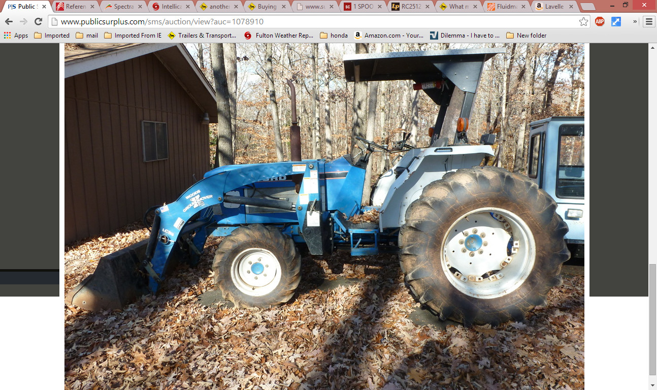

This 40HP 4WD Ford w/ FEL went for $8.4K.
Public Surplus: Auction #1078910
