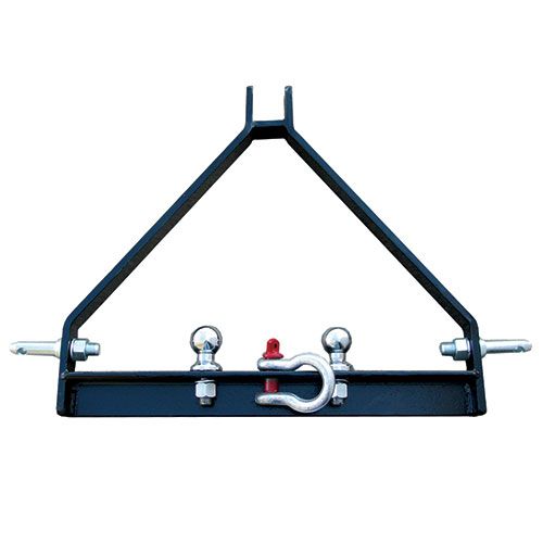

3. Pull a trailer ~~~ Sure. You need an A-frame attachment for the Three Point Hitch. PHOTO #1
