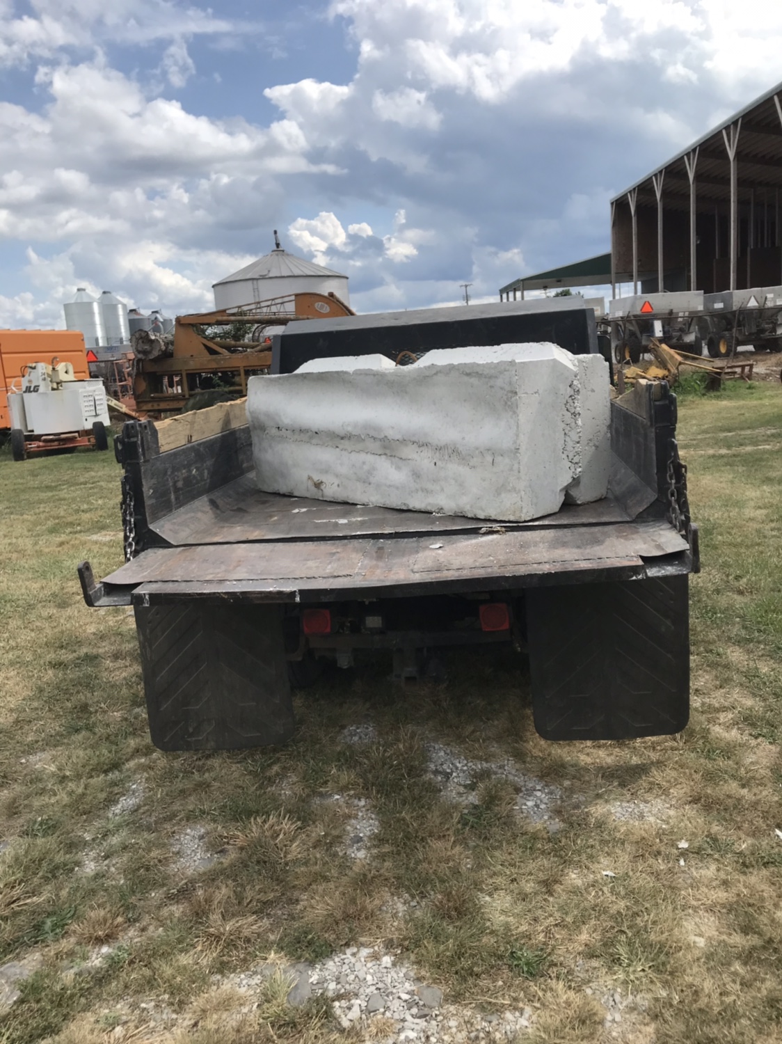

At 15k budget a tractor is your best bet. Throwing the budget out the window a CTL is infinitely better than a wheeled skid. If you’re talking about those standard pre cast concrete blocks like this you can forget about moving them with a 5,000 pound machine. My buddies Gehl skid steer weighs 7,000 pounds and will drag them around but can’t lift and set them. My M59 weighs 8300 without the optional weight it has and will just barely do it. IMG_7556.JPG

I think you’ll be better off setting the blocks with a big CTL. Rental minis bigger than 5 tons are fairly rare and they won’t set 2 ton blocks. If you can get a big enough mini than it would be for the job.
Yes, 2 ton blocks would be tough to deal with for sure.
