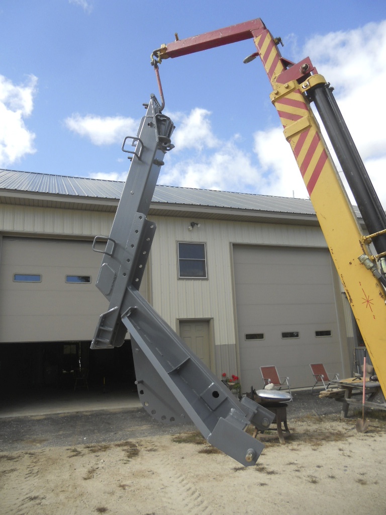

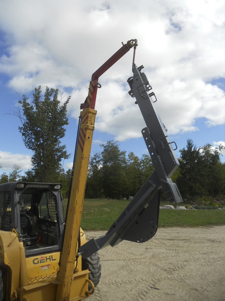

6X6X.25 sq tube outer, 4X4X.375 inner and about a 90" cyl. Sorry, these pics are more about what I was doing rather than the "pole".

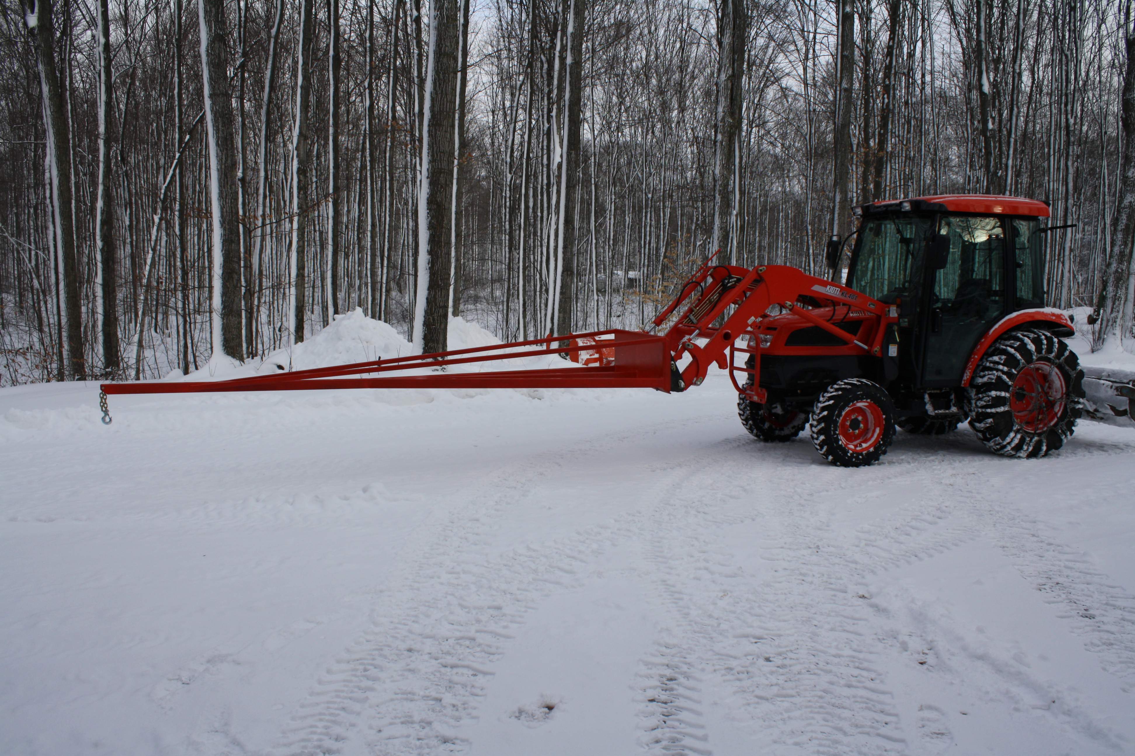

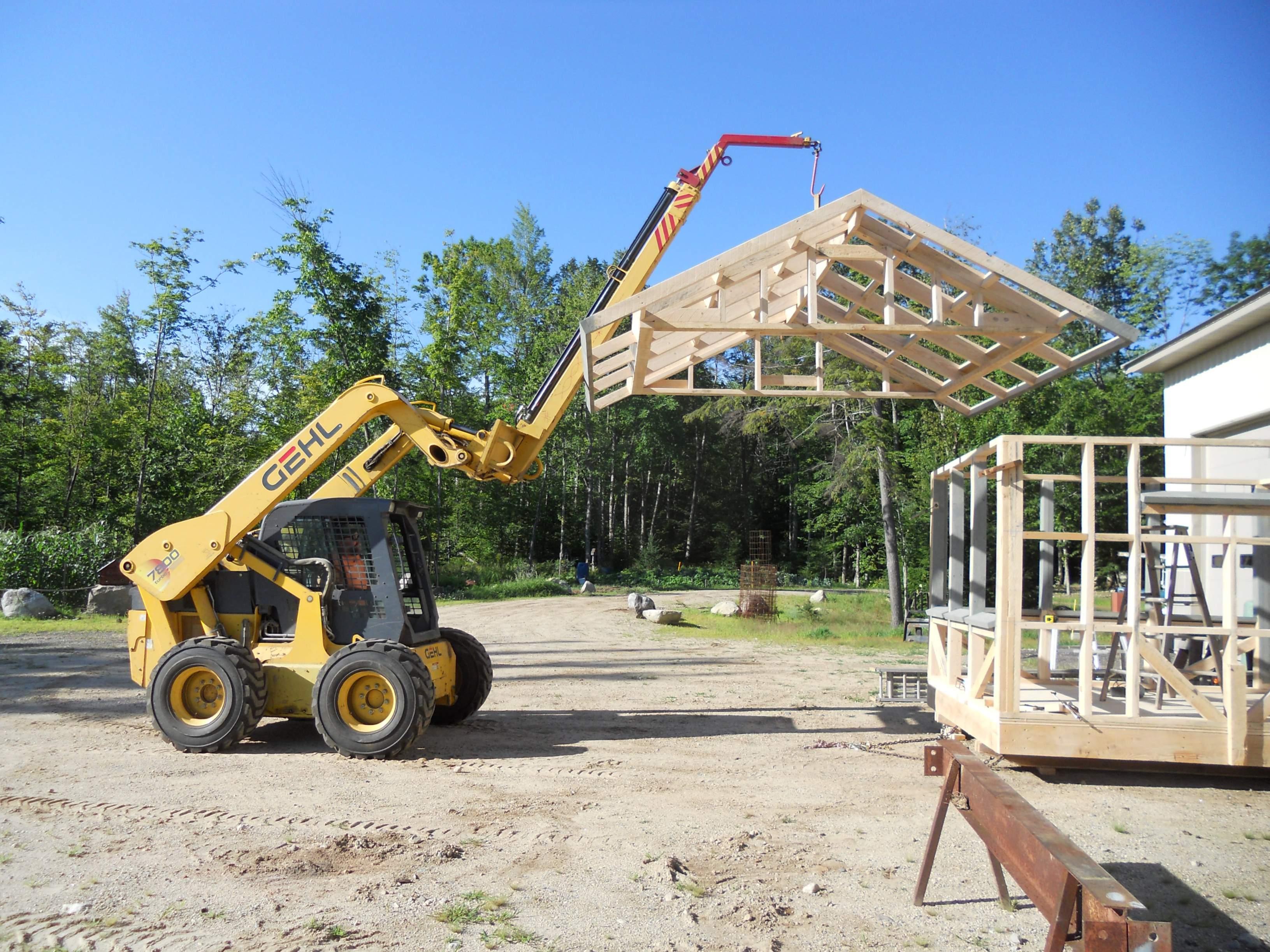

boom pole 010.jpg This one is not hydraulic but I just found the next smaller tube that fits inside and use the hook bolt as a anchor for adjustability. I have not even purchased the extension tube yet. I have not needed it. This one will set trusses on a 30' wide pole barn. CJ
With a 7810, I can understand why you are using a 6x6 tube. Wish I had the capacity of the machine, but they're just too wide.

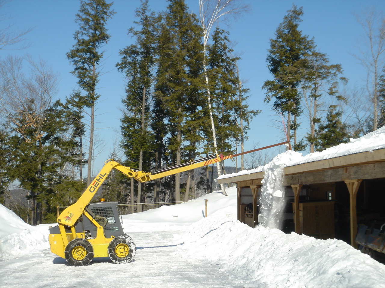

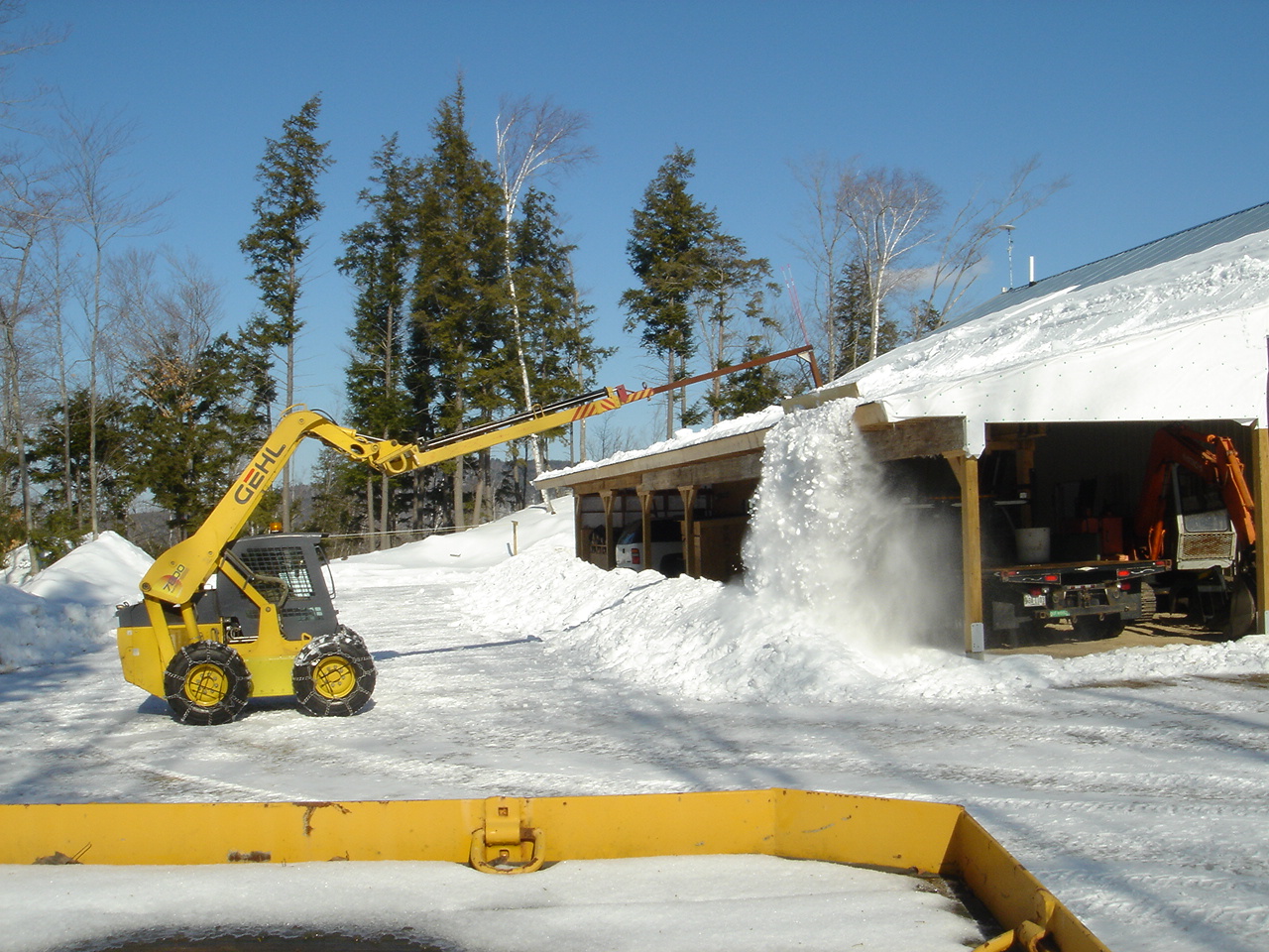

That's pretty much what I'm looking to build. Can I ask what your material sizes and lengths were? What is the lifting capacity of your tractor and have you tried to max out the pole?
2x3 tube 3/16" wall. This will allow a 2.5" x 1.5" inner sliding tube. 14' main tube with 1" brace tubes 1/8" wall on the 1" square tubes. This was all built on a 3/8" thick skid steer adapter plate. Tractor will lift at least 3000 just off the ground and I have picked 1200lbs at the end of the pole. Tractor will not curl it but it will lift with the main cyls. With the bracing nothing flexes at all. I cant max out the pole with my tractor. CJ
