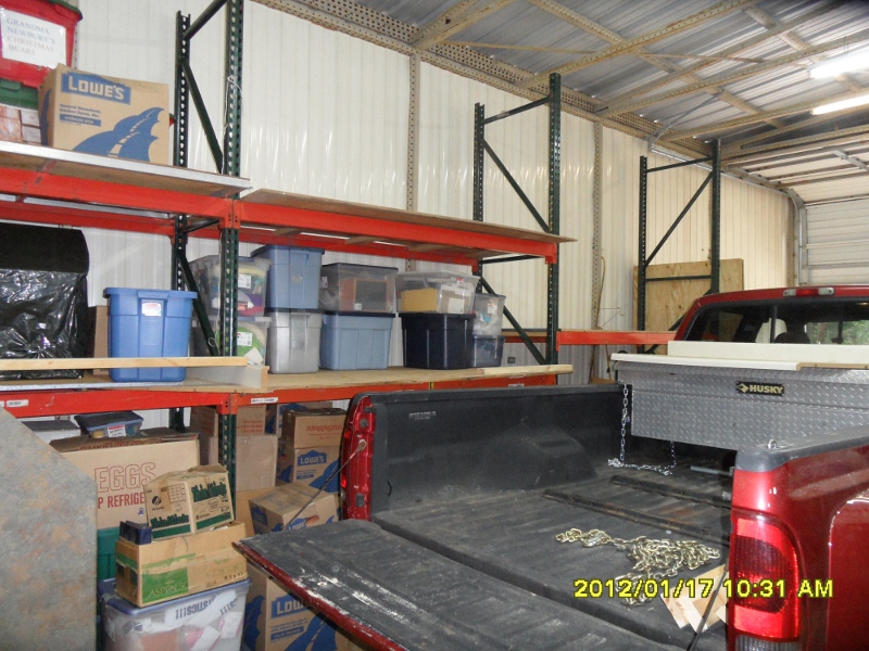

What do you need for "structural steel"?

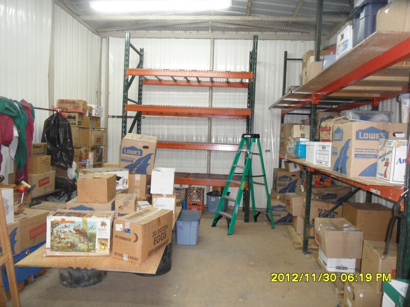

My "RV shed" structure (focus on the greyish outside elements)
attachment.php
attachment.php
appears to be built out of pallett racking uprights.
I've often thought of another building with 14' high sets of pallet racks comprising the outer framework.
IF YOU DON'T HAVE TO WORRY about high winds and extreme snowload all you need is a sturdy skeleton to fix the sheets to.
