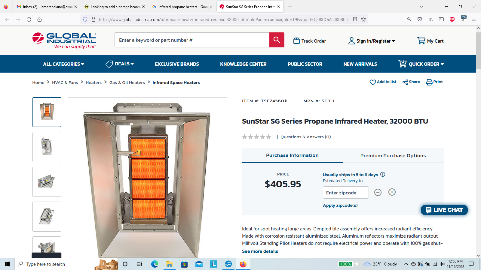

While I'll second the idea of the mini-split heat pumps.
I would also look at the infrared propane heaters, they will heat the occupants and equipment even when a door is opened either moving stuff in or out or with a door opened for ventilation for running vehicles or welding fumes.
