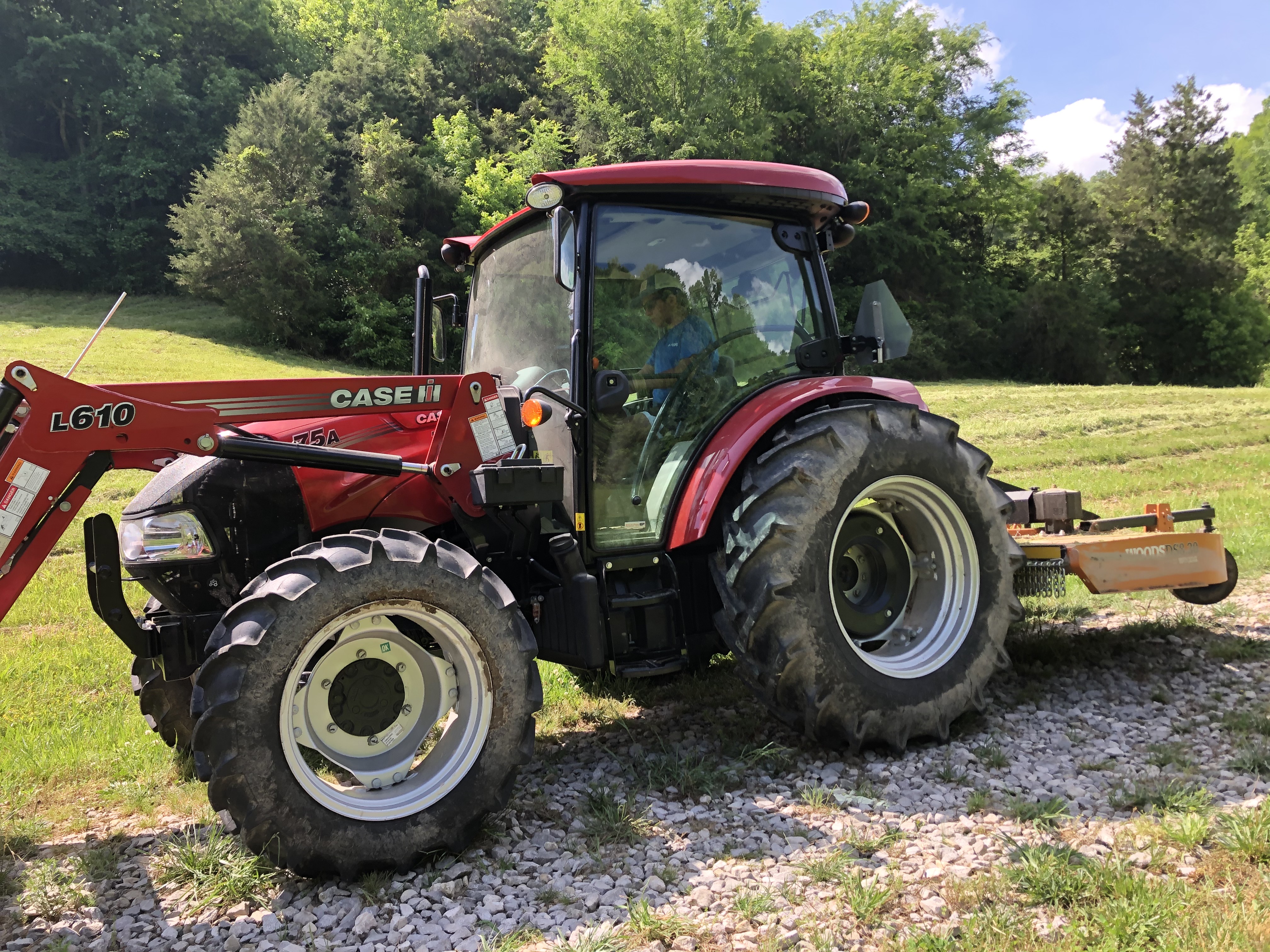

I'm on a computer this morning, which I find so much easier to use than my phone for this website. Here's a pic from this weekend- I've done about 10 hours of rotary cutting with it this month. Since you're looking at the NH, ignore the color. Everything I've read says the Case and NH are built in the same plant, same options, same packages, just different color. I went with the Case over the NH due to a relationship with our local dealer.
