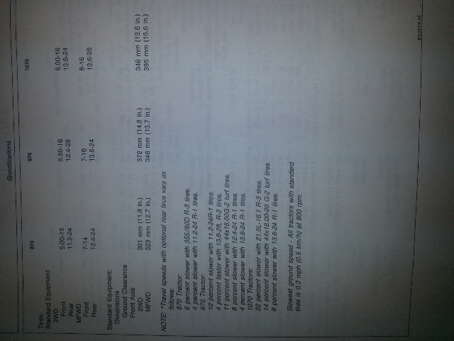

   / Looking for Turf Wheels/Tires for 1070
   / Looking for Turf Wheels/Tires for 1070 #8
Well here is the tire section. It doesn't look like it's much help for you though as it doesn't mention the fronts with turfs. Sorry.
#9
Yeah I guess that's kind of confusing. It doesn't seem to mention the fronts on any of them.
I suppose I am still a bit mystified about how tractor tire sizes work. I am used to cars/trucks where let's say a 255/70R16 = Radial tire, 255MM wide with a 70% aspect ratio on a 16" rim.
These tractor sizes like 21.5L-16.1 don't make sense to me. It would seem like the 16.1 would be the rim size, but is there really such a thing at a 16.1" diameter wheel?
jdparts lists the front turf tires as 27/8.50-15 and the rear as either 44x18 or 21.5x16. The 21.5x16 shows as NLA. So yeah, I'm a bit confused.
Michael
