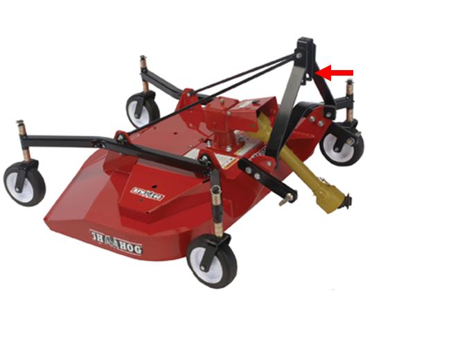

I have a Bush Hog finish mower for my rear PTO. I will raise my hand and say other than raising and lowering the thing I'm somewhat lost on the finer points of operation.
A friend of mine - who does know more about tractors than me - said there should be a way to "free float" the mower deck so as the tractor goes down an incline the deck doesn't go way up in the air and not mow the grass. I have lots of hills to be mowed and once I get into the old field part of my property it's REALLY uneven. I'd like to be able to mow my grass without it looking like I did the whole thing blind folded with a pair of scissors. :confused2:

The upper attach point on the mower should have a "U" shaped part that pivots (red arrow in the attached picture). That's what allows the mower to free float.
After that, your top link of the 3PH should be lengthened enough to allow that free floating device to function.
I'm thinking you might be tightening up the 3PH top link to transport the mower raised. That's fine...
But when you get to where you want to mow, you need to lengthen it.
Also, make sure your rockshaft lever (lever that raises the 3PH) is set so the mower is completely down on it's four wheels.
I'm guessing you have a 60" or 72" mower. If your lawn has a lot of rises and depressions, the mower may be spanning those lower sections. I have that problem, but I'm going to live with it.
Of course, make sure your mower's blades are sharp. If you haven't sharpened them in the last season, perhaps you should.

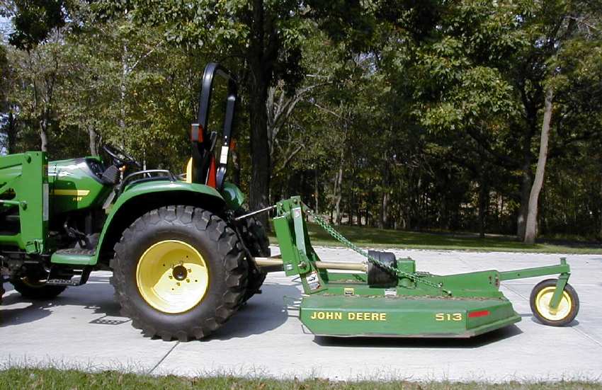

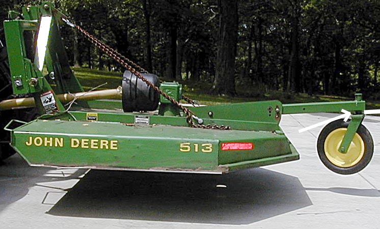

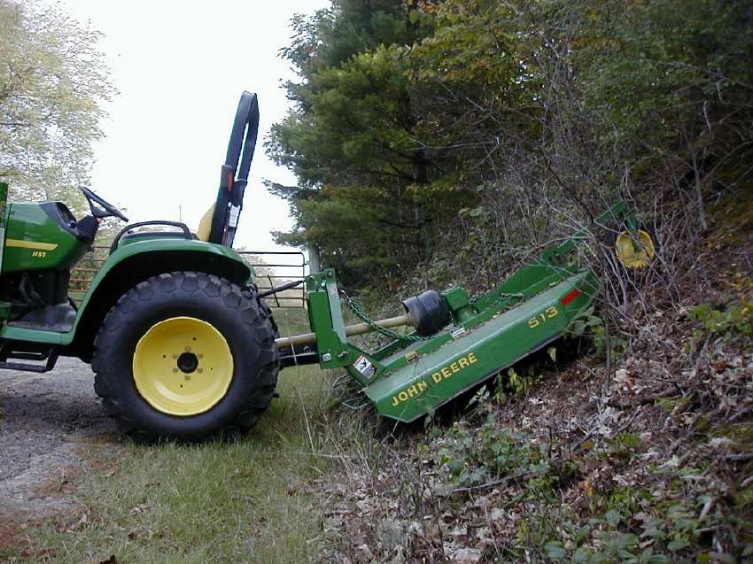

To fix mine, I removed the steel brace straps from the top link connection to the rear of the deck, and replaced with chain. Works like a dream for me. Top arm (true hyd) adjusted to allow the rear deck wheel to follow (float) with the ground.
Before the iMatch, I just replaced the top link with a short chain for free motion, but short enough to raise the deck for road travel (no banging :) )
I believe she was asking about a finishing mower, Beenthere...
   / Looking for thoughts on free floating my mower #7
The same will work for the finishing mower :D
The idea is to get rid of the stiff arm that restricts movement for allowing float.

The U-shaped device that Roy pointed out is called a floating toplink bracket. If it's missing, get one. Because when you want to transport the mower, you tighten up your tractor toplink (screw it in) as far as it will go Assuming you've got the correct toplink, that should ideally point the open end of the U at the tractor. When you get to where you're going to mow, you lower the mower so all four wheels are on the ground. Then extend (unscrew) the tractor toplink until the open end of the U is pointed straight at the ground. When you're done mowing, adjust the tractor toplink so that the floating bracket is once again in the transport position.

I disconnect the top link in one section due to very abrupt beginning of a slope. Otherwise, the mower cannot follow the change in the slope.
Personally, I prefer to keep it on (loosely as Greg and I described) for all other mowing.
I have to disagree with Beenthere on using just a chain, but if it works for him (and it has for years...those pictures aren't recent)...great. First time that cutter jumps due to hitting a stump (that'll soil your skivies), he might use a solid link. But he's not the only guy I've read here and seen in real life using a chain top link.
