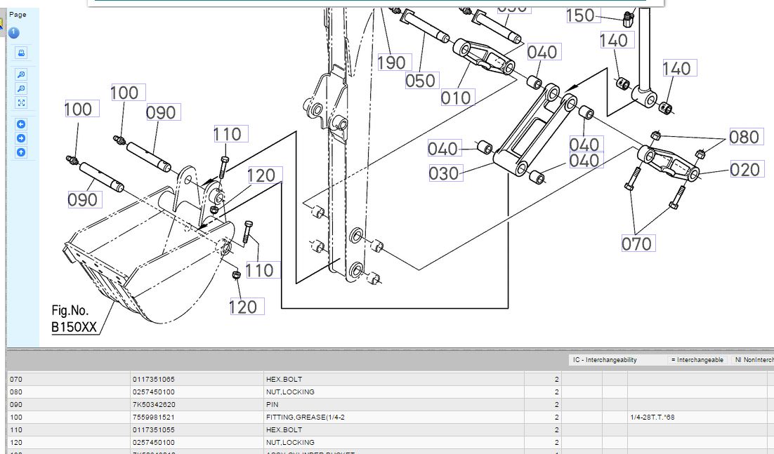

I have a BH 77 that I bought new 4 months ago and the second time It was used it broke the pin that goes through the bucket. This is the pin that has a square tab on one side and the bolts drops through on the other side to keep it from coming out with a grease fitting in the end. I call the dealer that I bought the tractor and backhoe from today and was told that Kubota does not build a BH77 that they only offer a BH 70 and BH75. What freaking idiots that same dealers have working for them. Does anyone know where I can buy this pin? Thanks
   / Looking for the pin that goes through the bucket on a Kubota BH77 backhoe #2
try different dealer, give them the size of yours and see if the other models are same or get one made at machine shop
   / Looking for the pin that goes through the bucket on a Kubota BH77 backhoe #3
Here's a pic of the bucket parts list
BH77 BUCKET....click diagram to enlarge

With the parts diagram you can order from local dealer or messicks. B21 uses same bucket pin.

Here's a pic of the bucket parts list <img src="http://www.tractorbynet.com/forums/files/kubota-owning-operating/420976-looking-pin-goes-through-bucket-bucket-jpg"/> BH77 BUCKET....click diagram to enlarge

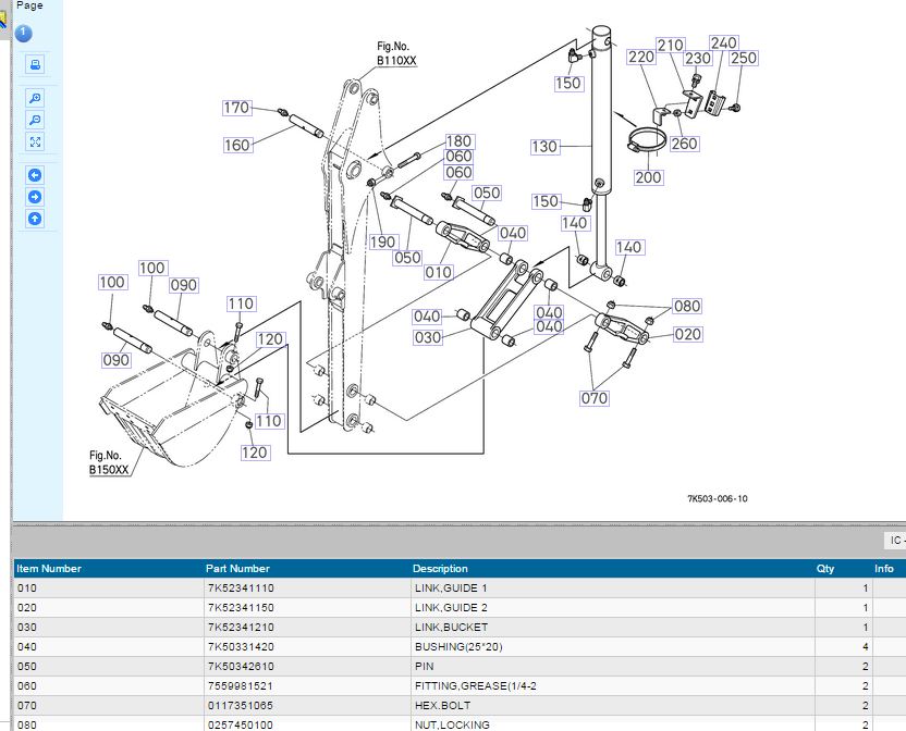

Thanks for the help, dealer called me back this morning and told me I was wrong about the model. Parts manager told me again that Kubota never made a BH77 but they did make a BH1976 wow really must be some good stuff he was smoking. The part I'm looking for is number 050 in the picture but the part number got cut off the the list.
   / Looking for the pin that goes through the bucket on a Kubota BH77 backhoe #6
Go to messicks website they have parts list keyed to parts numbers. There is a bh76 same as bh77 same as bt751 (b21 hoe) with respect to bucket pin.
   / Looking for the pin that goes through the bucket on a Kubota BH77 backhoe #8
Here's one with #50....
