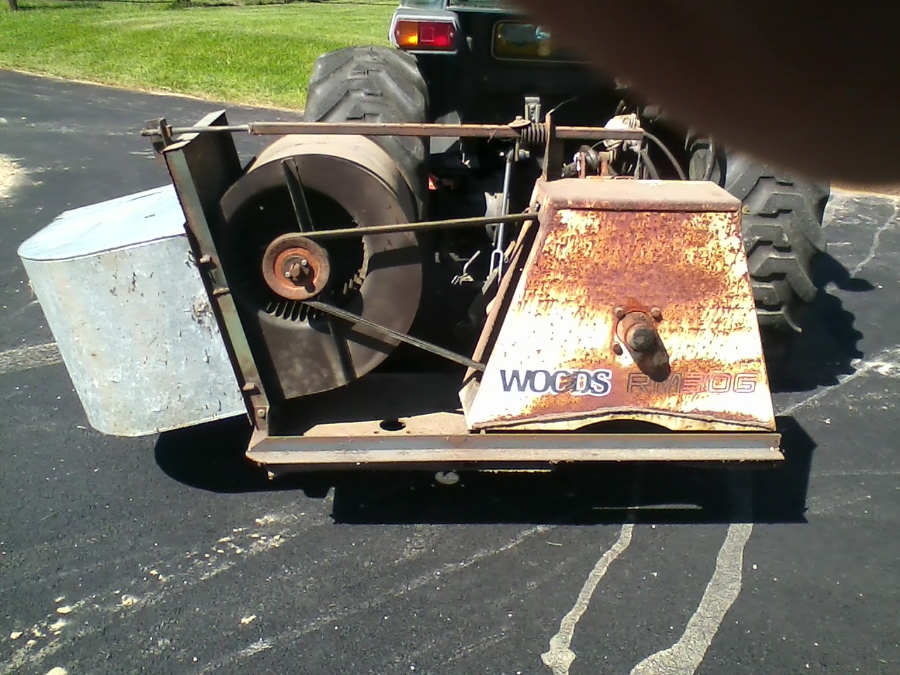

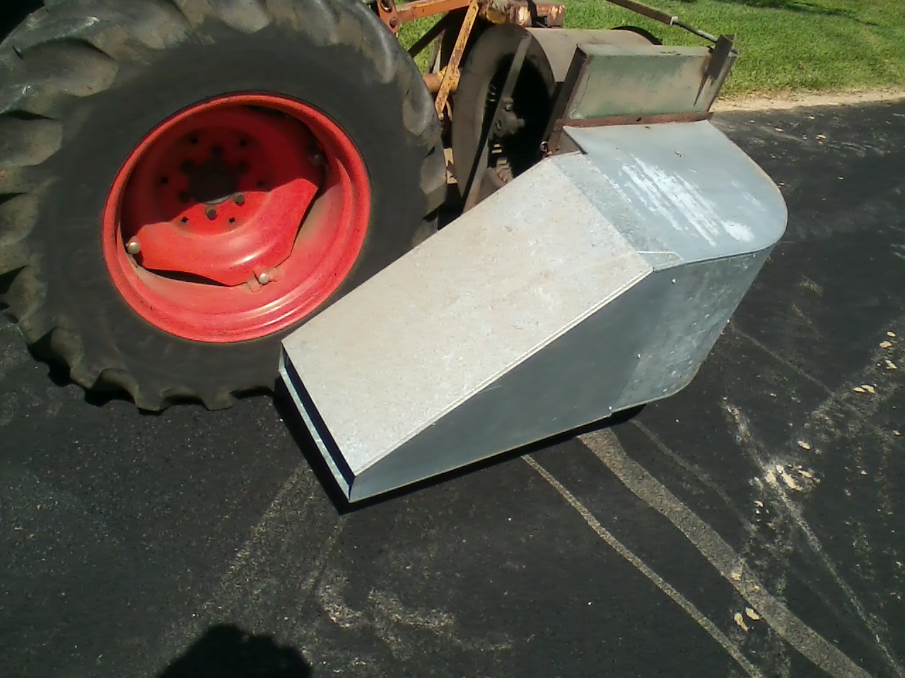

We would like to improve on our driveway blower.
It blows good, but you know, we want to Tim Taylor it.
We have a side discharge as well as a front discharge. Each has it's good points, but takes time to change.
Also when we run full speed, it makes the fins come loose on our blower wheel.
So, I am thinking, we need a heavy duty blower, maybe like sawmill collection blower, then put a hydraulic controlled discharge which we could change direction of discharge on the go. Of course, might go another route & make a vacuum system out of it.
Where might we find a blower that would load up to, maybe 20 HP, and we could run at half throttle, but move Tim Taylor type air.
Any suggestions appreciated.

Yes, we are familiar with normal blowers with electric motors having to be partially blocked to keep from overloading the motor. In this case we are just overloading the wheel because we have power to spare. We have tied baling wire around the outside center of the wheel, trying to hold the fins down. All we have to do is slow down the engine rpm to keep this from happening. But you know old TIM, when something sticks & you want it to move, it is hard not to open the throttle a little. We have kept back a spare blower wheel for when this one comes apart completely.

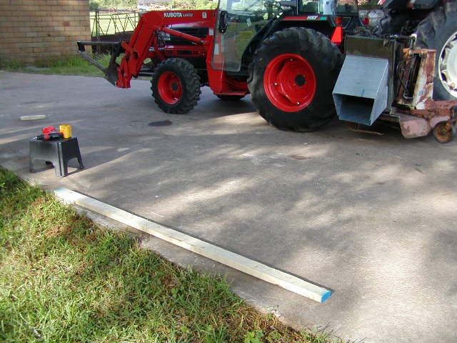

In that last picture with the 2x4x8' shown, it will blow it off the drive, I think, somewhere around 1/2 throttle, at the distance shown in the picture. If you walk in front of it while running, when you pick your foot up, it will not land on the intended spot to put it down.
Just thinking, if we had a paddle wheel blower, maybe it could take all the kubota could dish out.
