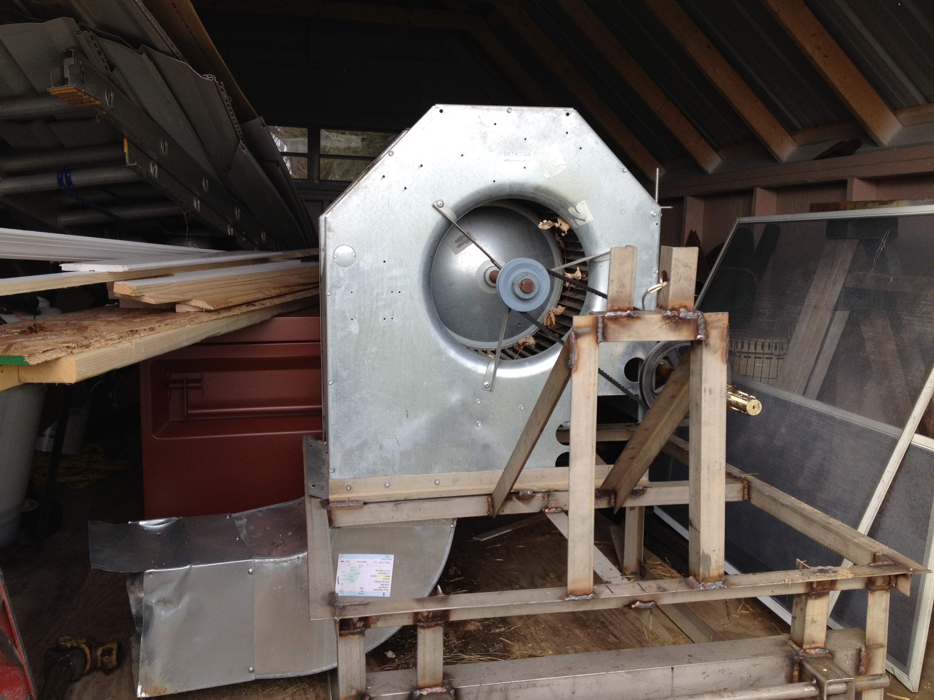

I'll be watching this to see what the clever people come up with. I know there are implements like TracVac out there, but I'm cheap and like to tinker. Right now I blow leaves into the fencerow and fields that border my property. For that I took a blower from an old HVAC unit that was removed on a project we were doing. It mounts to the 3PH and runs off the PTO. Driving at a slow pace it clears about 6' on each pass.
It would be nice if I didn't have to drive in a particular direction and could pick the leaves up and dump them. We don't usually get enough snow here to justify a snow blower, but that doesn't mean it wouldn't be nice to have one at times. At one time I was thinking that it might be possible to fab a skirt for a snow blower to have it do double duty as a vac. Wish I could talk Wifey into a pole barn so there was more room to play.

Do you have any pictures of your HVAC to PTO leaf blower ? A very interesting idea. I just scrapped out 2 10 ton air handlers that came out of my commercial building because they were 220 volt. I wish I had thought of your idea before.

Others have done this before me. Not the best photo, but here it is crammed into one of the sheds. The fan discharges out the bottom and I made up a crude discharge chute to blow the leaves to the right. I fiddled with the duct's shape and it seems to work best with a larger opening. The squirrel cage provides a large volume of air when the duct opening is larger. Transitioning to more of a nozzle doesn't work as well because the fan likes to make volume more than pressure.
It attaches to the 3PH and has skids for when it skims the ground. I calculated the pulley sizes to approximate the fan speed it was designed to run at when installed in the air handler it came from.
