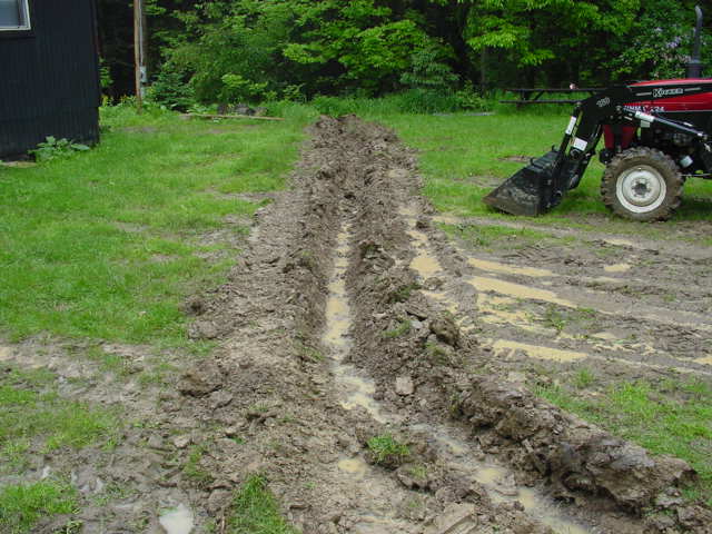

Here are a few pics of a ditch I dug with mine. It was for 4" corragated drain.

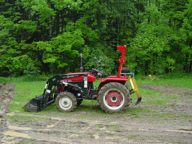

   / Looking for something that will............ #5
pic2

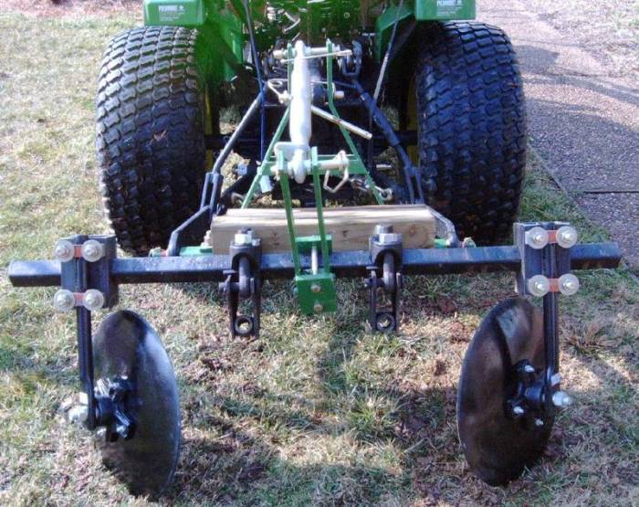

One of those middle busters, potato plows or V plows will do this, like others have suggested.
This is another case where a Gravely type rotary plow mounted on the 3 pt would be a great tool. Gravely folks use theirs to dig trenches and post holes and, yes, to plow.
You could also cut a trench with a disc plow, particalary a pair of them mounted to push the soil away from each other. Attached are a pair of mine that that I used to make raised rows. Mount them the opposite way and angled opposite, and they'd dig a trench. Look for disc hiller rigs on Agri Supply or TSC. Got my discs from Agri Supply. They're mounted on the diamond bar of an old soil ripper a friend gave me (and that friend did the clamps for the disc shanks). My little 4010 will pull twin 20" discs opposed 45 degrees. Agri Supply and some other outfits have clamps for the more standard square bars now in use vs. the old diamond bar on the old JD Ms where mine came from.
