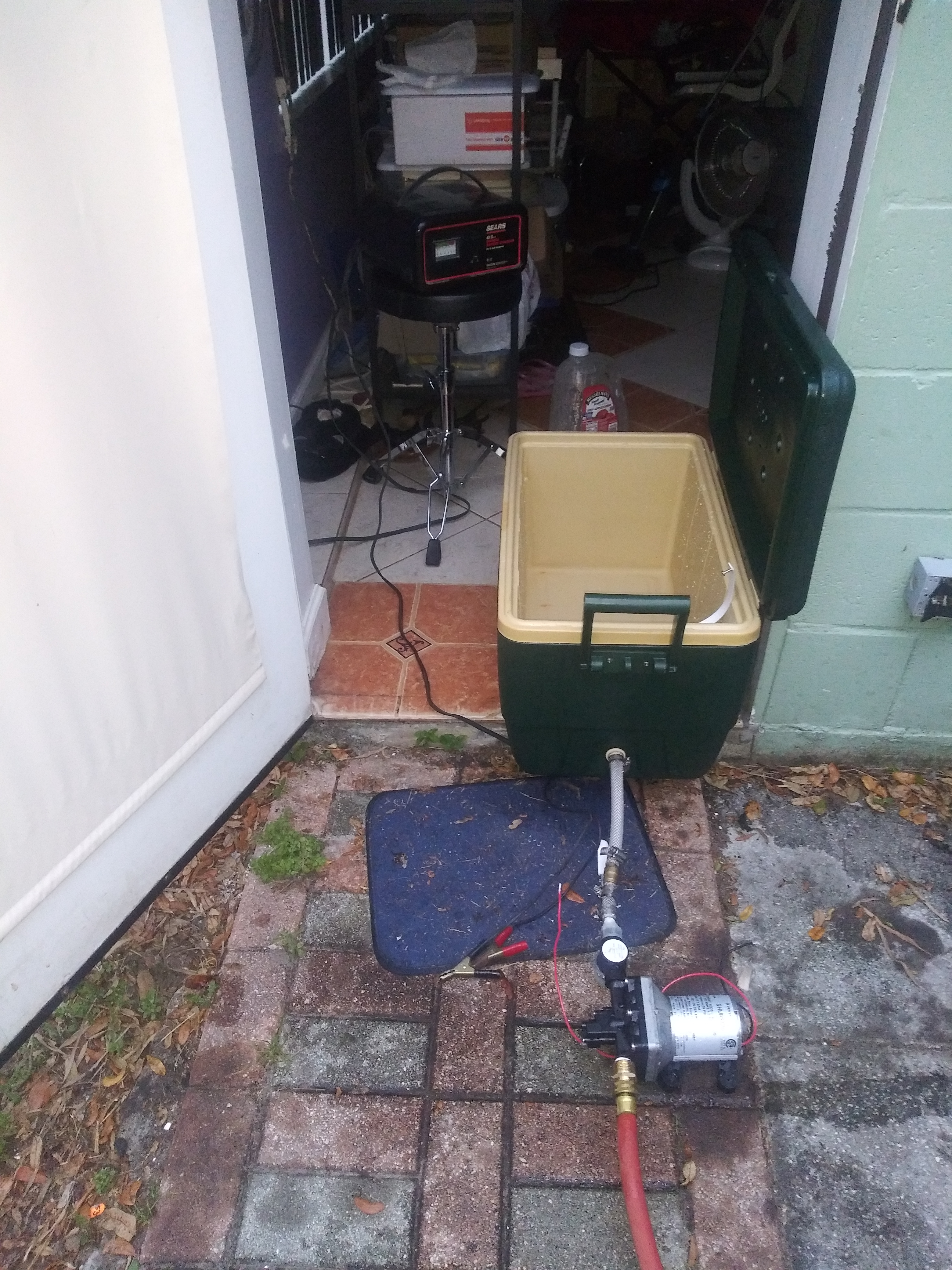

I have been hand watering about 300 trees on my property using my generator, a small 120V 10 amp pump and a 275 gallon IBC tote. I pull these around using my trailer and Ranger.
Im gonna burn up my generator, it takes a few hours to accomplish this and Im looking for an alternative.
I thought that I may have been able to use the small pump from my RV and hook that to the battery of my truck but Ive found that there isnt nearly enough water pressure with a 50 ft hose nevermind once I were to add another 100footer. Its only rated for 3GPM and the large garden hose diam almost kills any sort of pressure.
I could go buy a cheap H.F gen that will supply the needed 10 amps to run the same pump Ive been using but Ive only got to water these trees a few more months until the rainy season is upon us again and then Im assuming I will be pretty much done, they will be large enough to support themselves.
Id rather use the money some other place in other words, any ideas?

You could use this inexpensive 12v pump, hook it up to your ATV, and pump 8-10 gal a minute. I've used one for 4 years to pump diesel, hydraulic fluid without any problems. Couple of my friends have bought them and like them as well.
Since you want to pump water instead of oil, I would think it would work great for you.

Thanks, Ive read that these types of pumps are continuous flow though, Ive read that turning them on and off via a nozzle will burn them up in short order.
