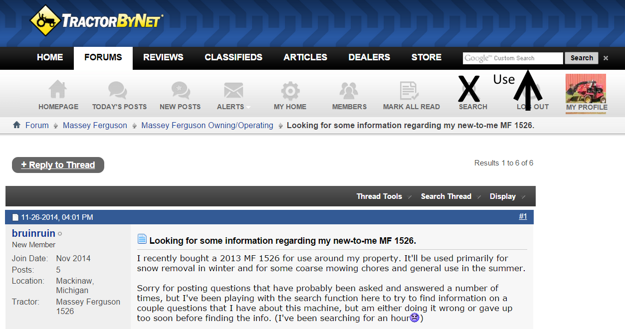

There are many threads on rear work lights. Type led rear light in the Google Custom Search box, it only searches TBN.
2014-12-10 10_06_54-Looking for some information regarding my new-to-me MF 1526..png
