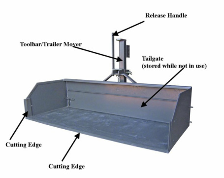

Looking for review of Pat's Easy Mover 4 or 5 foot 3PH Rear Bucket. I have searched the forum and come up empty. It looks interesting. I like it for it's cost vs an FEL, a front JD QUick Hitch Bucket, or even the Johnny Bucket. I don't need the high lift of an FEL. It also doubles as a Tow Bar/Hitch. Also can be a Carry All. You can see it at trickmytractor.com. Manufactured by the same company that makes Pat's Easy Change 3PH system.
Planned usage - Distributing gravel annually on driveway. Mulch annually. Carry All. Misc small property (7 wooded acre) hauling and moving.
Thanks

For those like me that didn't know what it was, here is a link and a picture.
Pats Easy Mover, 5 Foot Model
Surely someone on here has one.
   / Looking for review of Pat's Easy Mover 3PH Rear Bucket #3
Unless you have a hydraulic top cylinder for your three point, I don't see it being much good for moving gravel. You could scoop it, but then what? I think a box blade would be better for gravel and a 3pt carryall or set of pallet forks with a pallet and wood sides would be better as a carryall.

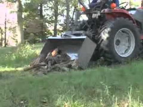

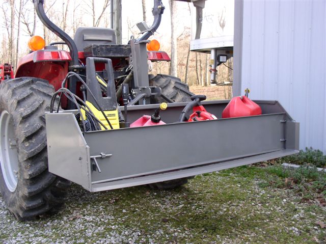

Here are two more pictures
And here is a link to the MFG website with more pics. http://www.greenwellmfg.com/uploads/2/8/2/0/2820177/7746913_orig.jpg

Yes it dumps. But my understanding is it is an all or nothing type of dump.
This means you have made a smaller pile of material from a larger pile of that material.
Look on craigslist or FB marketplace and for about the same money, buy a few different implements ( pond/dirt scoop, a carryall, and a trailer mover) which will do the jobs you listed and greatly reduce the risk of damage to your tractor. If you shop around a bit, you will find these and actually spend less if you can easily pick them up fairly locally as shipping is rough on this item. Carryall frames can be purchased new if need be for about the dollar of a used one with a deck if you have special needs for the deck.
Yes the pond/dirt scoop is going to be a largely dumps in one spot also, but good used ones can be found in my area for less than half of this item prior to shipping.
Hopefully, you already have a box blade or straight blade as you will need it with either this item or the dirt scoop!
