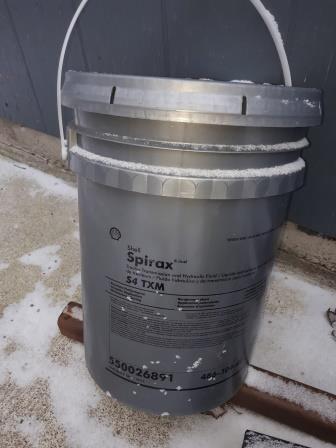

I use this in my 2012 DK45 SE HST.
I put this in at my 400 hour service. It works perfect for me. Some tractor owners complain of HST whine with different fluids but this is fine by my standards even in cold weather. I don't think these model tractors are noted for having much of a whine.
If you do change it save yourself some $$ and just buy two cans, (10 gal). The specs say 11 gallons but you will not get a full 10 in it.
I have over 500 hrs. now and the fluid is as clear now as when new.
