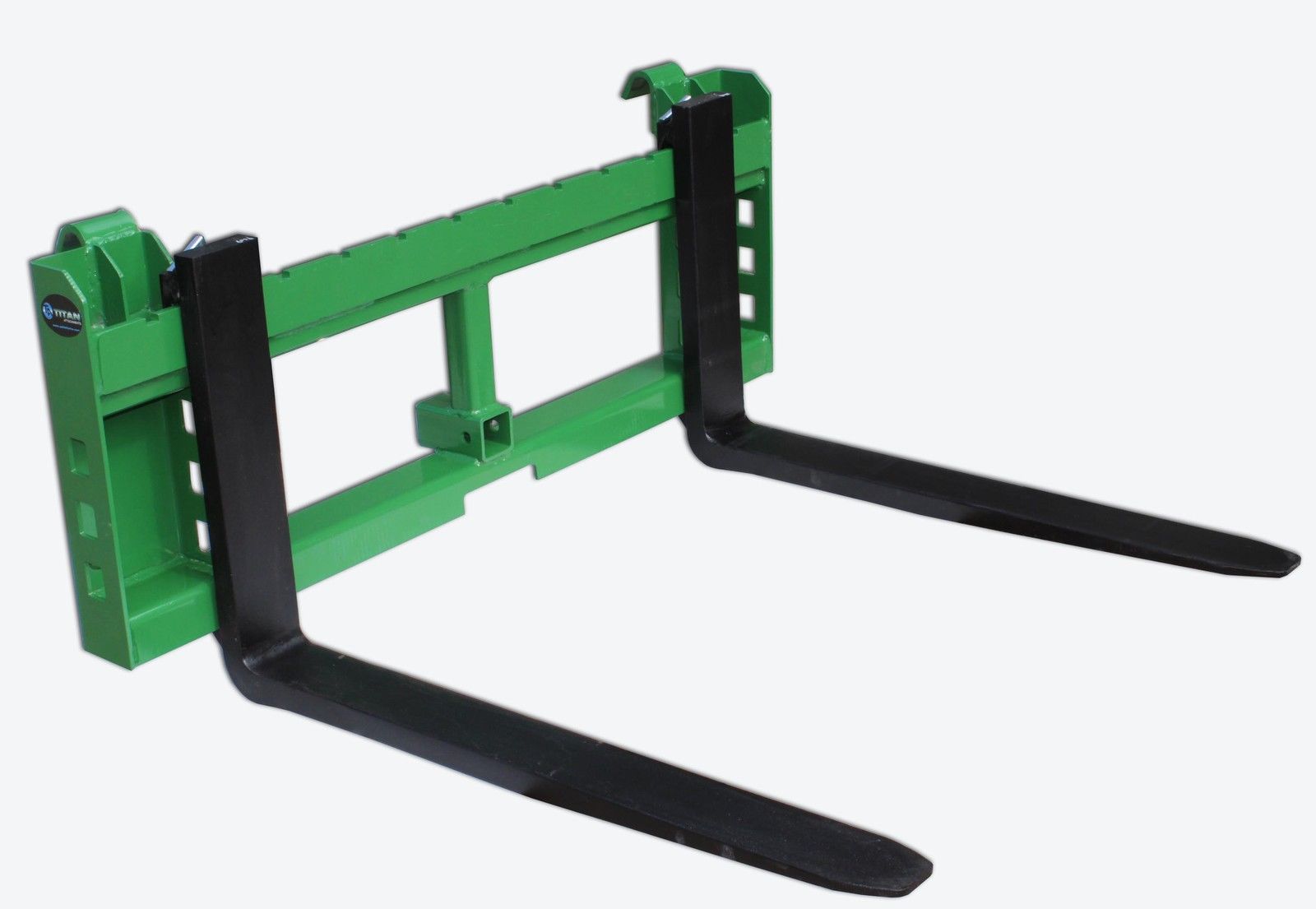

By the time you bought all the steel you need plus your time and electric (for welding) to build you could buy those ready made and free shipping.
   / Looking for plans to build forks for john deere tractor #5
I would rate the set I bought (the 42" from ebay above) as one of the best buys I have made.
   / Looking for plans to build forks for john deere tractor #6
Here is their Website: Attachments for John Deere - Tractor Attachments
You will have to verify that they will fit your loader.

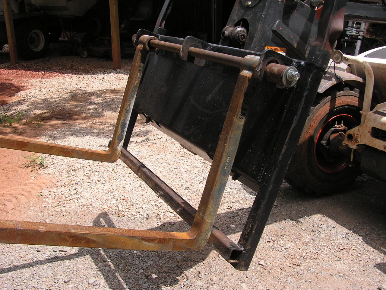

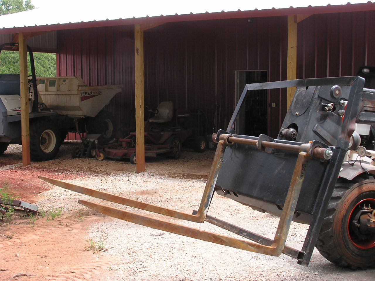

If you have a SSQA on your Deere, it is chaper to purchase a set. However the 790 I had was equipped with the JD QA so I made a frame to hold a pair of forks I had scrounged. They were off of a 4000# Clark truck and way more than needed. There are threads somewhere on the site that have photos of mine.
