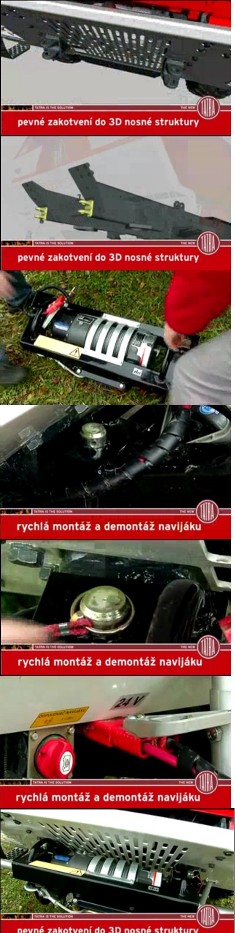

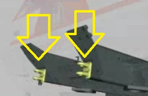

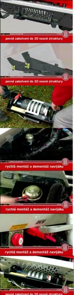

I'm looking to make a quick detach winch mount for the back of my Unimog (its sort of a tractor :thumbsup: ) And I found exactly what I want, but I'm not sure where to get the parts.
The idea is have 2 mounts on the back cross member, and then the winch in a box that slides on, 2 heavy duty pins, and 2 Linch pins to keep the pins in place.
I know where to find the Hitch Pins with Chain and Linch Pin, but where could I find weld on mounts like shown in the picture and video? That would accept a heavy duty hitch pin? Would those have to be custom made? Or is there a similar part that I could adapt?
Basically exactly as shown in this video:

I would just use receiver style as it can be used for many other things also.
   / Looking for parts supply - Frame mounts #3
If you had a Mog with a 3 point, this would be simple :p
Standard receiver hitches are not made to be side loaded, so be careful if you put a winch in one.
Receiver hitches are too useful to not have one, so I'd probably beef up one somehow.
It's an 18,000lb winch, I don't think a standard hitch will be up to snuff. Custom it will be, but I was hoping to find the frame mounts to build off.
