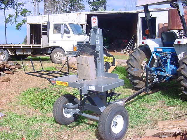

Stickyboy, here are some pics of my logsplitter,it is manufactured in Oz ,I power the unit with my 1920 N.H.It is called a Mini Superaxe.Makes life a lot easier.There is a website,http://www.superaxe.com.au. I hope this may give you some ideas.Kerry in Oz.If you have an E.mail address I can E.mail the brochure to you as it is too big to put on the forum.K

Heres a Case splitter on the back of one of my Ingersoll tractors. The Case/Ingersoll tractors put out about 8 to 9 GPH out of the hydro system. The splitter splits on bolth the out, and in strokes. This thing works great. The stroke is a little slow, but makes up for it in that it splits bolth ways. I just love using it, I can't wait till winter so I can start splitting some wood.
