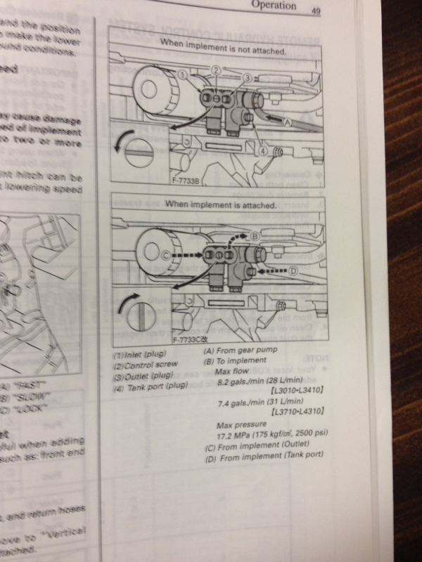

On my l3410 glide shift it has a block on the right side of the trans for the loader valve to be plumed into. It shows how to in the owners manual, I will post a pic or two in the morning from the manual.
   / Looking for LA682 Loader #4
Hope these pics help some. The book says it covers L3710 also. You might check into getting a bush hog or rhino brand loader for your tractor if the factory one is no longer available.
