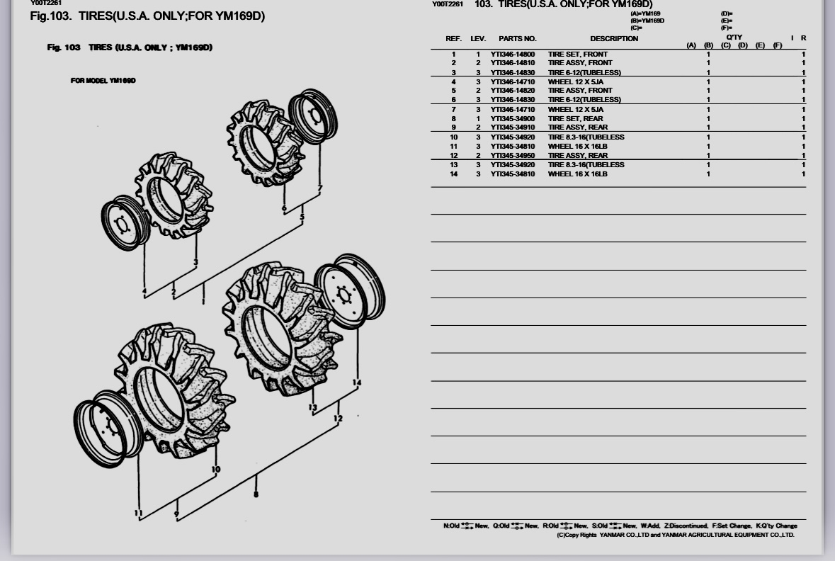

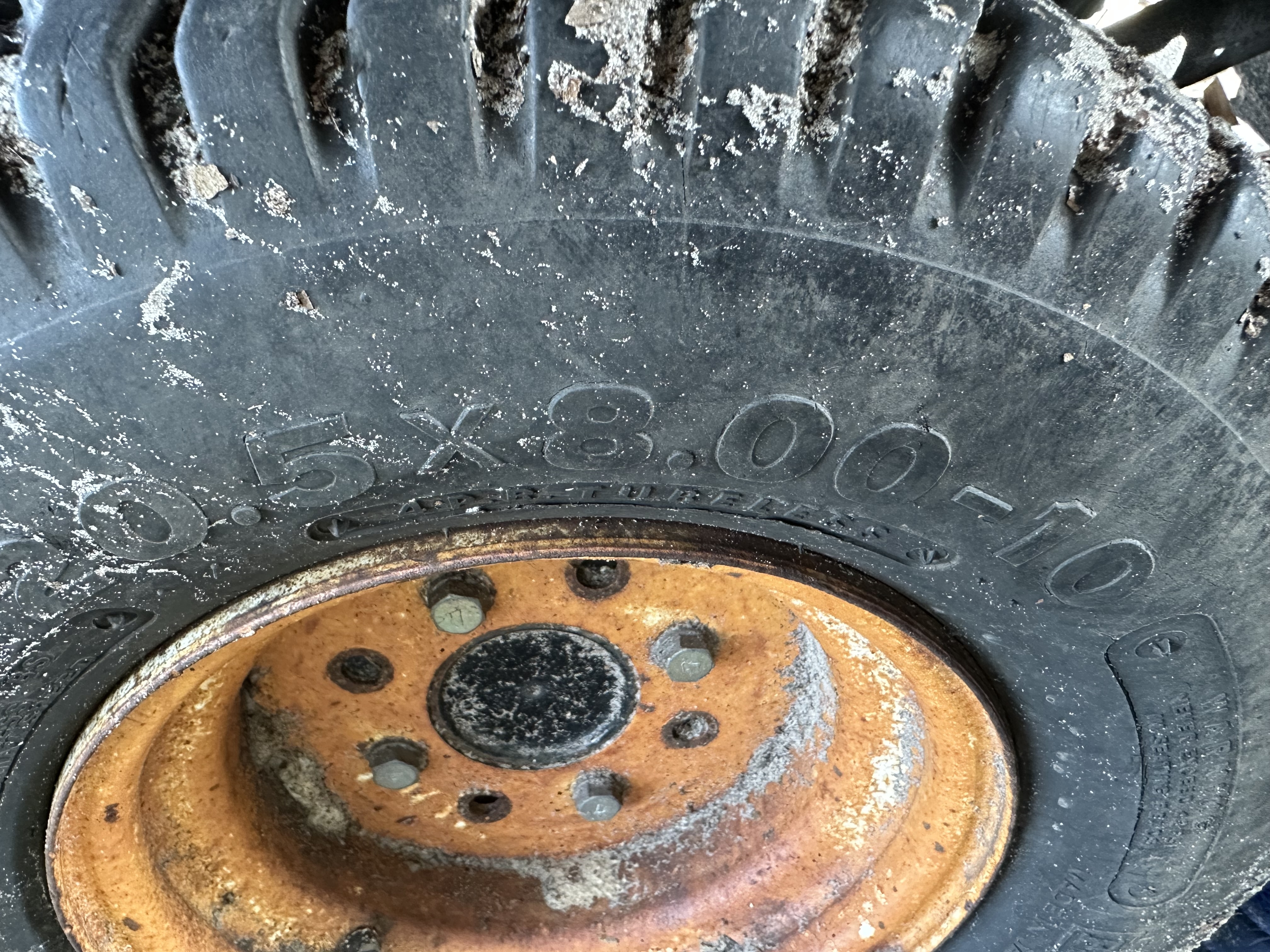

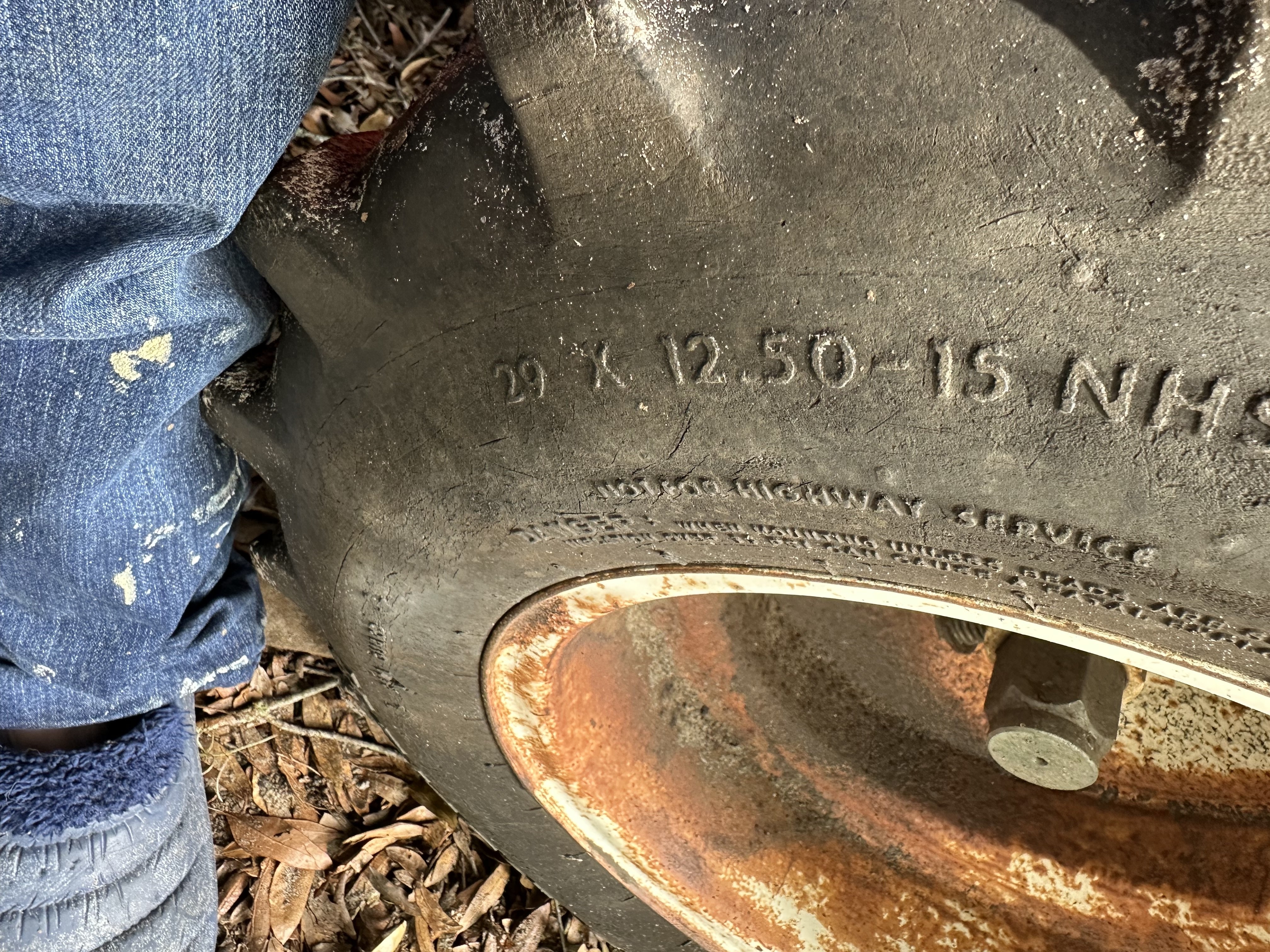

I looking to get new tires for my yanmar ym169(d). My tires have dry rotted and can’t be fixed. The wheels on it don’t match the specs set out in the Manuel. The spec are below
But what I have is different. Should I get replacement tires and not worry about finding new wheel and tires? Any advice?
0T2261|
103. TIRES(U.S.A. ONLY;FOR YM169D)
(A)-YM169
(B)-YM1690
REF.LEV. PARTS NO.(C)-
DESCRIPTION
YTI346-14800TIRE SET, FRONT
YTI346-14810TIRE ASSY, FRONT
YTI346-14830TIRE 6-12 (TUBELESS)
YTI346-14710WHEEL 12 X 5JA
N wYTI346-14820TIRE ASSY, FRONT
YTI346-14710WHEEL 12 X SJA
YTI345-34900TIRE SET, REAR
2YTI345-34910TIRE ASSY, REAR
10YTI345-34920TIRE 8.3-16(TUBELESS
11YTI345-34810WHEEL 16 X 16LB
122YTI345-34950TIRE ASSY, REAR
13YTI345-34920TIRE 8.3-16(TUBELESS
14YTI345-34810WHEEL 16 X 16LB

With any 4WD machine, you need to have a matching OD ratio with the rear tires to the front tires.
And in the matched ratio, there is a LEAD and LAG you need to follow. If you do not follow this closely, you can in time strip the kingpin and gears in the front 4WD wheels. Much of the time, when replacing 4WD tires, you replace ALL of them at the same time on the tractor or wheel-loader.
There has been extensive discussions on this topic over the years on the YTOG. The conclusion is, replace all tires to be evenly match to prevent these 40+ yo gears from failing. I had debated long and hard whether to have 2WD or 4WD. There were more pros for 2WD.
Look over this LEAD and LAG article.
Then use the calculator here,
NOTE, Titan tires have not been holding up well in the past few years, I only share the link to the calculator.
   / Looking for information on wheels for Ym 169(d) #3
If you jump on Amazon, you will find plenty of 6-12 tires. Check the OD of each!
Also, the 8.3-16 are commonly used on Kubota and Mitsubishi machines.
Amazon has more listings for free delivery. Since your machine is a smaller CUT, the tire size can be done at any semi-truck tire facility.
