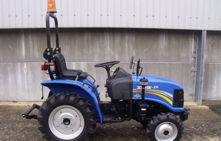

Hi oliver its a tractor that is imported into the uk under the solis name but is made by a company called vts tillers and tractors ltd its has association with mitsubishi who own a part of it and has built tractors for other company's solis is sonalika international again mitsubishi has share's in it along with yanmar the picture is of the model that preceded the solis 20 Solis_20_Rx_MFWD_(VST)-2010.jpg

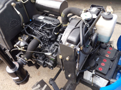

   / Looking for info on the mitsubishi mvl 2e engine #6
It could be a K3B, C or D. Page 5.
ok thanks Oliver
   / Looking for info on the mitsubishi mvl 2e engine #8
One more thing, look on the side of the injection pump. There will be a number cast on there that should be the cc of the engine. That should nail it down, as the B, C and D are all different sizes.
#9
Hi Oliber ithink its around 952cc when i get the tractor i will post some close up pics
