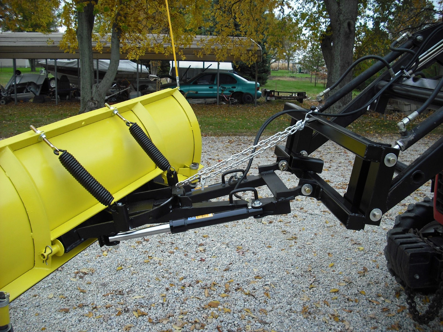

Nothing special there. I made one for my Meyer plow this fall. Any welding shop can fab it up in a few hours. Many of us here have done this. Make sure to put tubes to accept shoes on the mount in case you want to run your loader in float and also take the time to put a trailer hitch tube on it. Make a great adapter for moving them.

I think you are looking for a user called Northernmainer. He does build plates for Fisher plows. I used a very similar design as his and here are a couple pics.

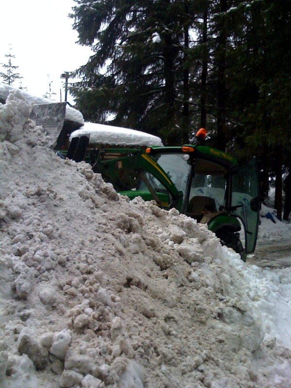

Thanks for the input on fabricating tou guys do sme nice work.
Hope the photo uploaded so you can see what I am up against.

Where do you buy the hooks and pins for the 300 cx loader mount? Directly from John Deere?
Yes, JD sells them or they are easily made...I am at work now without pictures or links-but you can search the term "hooks" in the JD forum or wait till later and I will post more info.

Here are some more photos of my snow situation. Still want to go for a fisher snow plow. Too much rock, gravel, and peoples junk under the snow to risk a blower.
http://www.summerking.net/snowplow.html
Put a few photos on my web site. I have just finished building a snow pusher will post a photo of that when I get a chance. Thanks to this site I have a pretty good idea of how to build the adapter for the fisher snowplow or another truck type plow.
