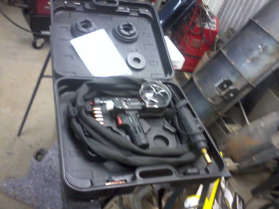

Have one, great allaround machine, i got the spool gun and cart too. 946073_345830632220708_1954754516_n (1).jpg

I'm thinking about the spool gun as well. Any problems with yours so far? I like the idea if the short feed distance.
Only problem, a minor one, I've had with mine is that I've broke off the little button that you use to release the pressure when you load a new roll of wire. Keep in mind it's not an industrial gun like the 30A (only rated at 160A) is but I use mine a fair bit and no major complaints, it was CAN$300. It came in a nice, fitted storage case that you can actually use, it doesn't require a degree in engineering to put it back in. That may seem like a small thing but if you don't use it much it'll keep it together and away from damage. It's actually more comfortable to use than a 30A, angles are a bit different, shape etc, just my opinion tho :)
I originally thought that 3/64 5356 wire was the better running one but I've since changed my opinion, .035 4043 seems to work better. Problem was the 5356 wire being stiffer, required a bit more tension on the spool to prevent unravelling, the 4043 is softer I can leave the roll tension backed right off so there's no drag on the spool at all. 3/64 is above what the gun is rated at anyway ( I had a few rolls kicking around is the reason I used it) so I guess it's not a fair comment. Saying that, smaller size 5356 might work, give it a try.
A good thing to keep in mind also is that it uses the same consumables as the MIG gun, nozzle, contact tip and diffuser.......Mike

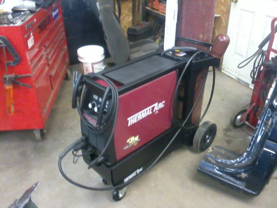

So far i find it to be a good machine, only thing i have replaced si the ground clamp. What i like is that the mig gun is pretty long, compared to my miller and lincoln models. I used the spool gun a few times to repare ski-doo stater casings and broken mag wheels, i use 0.035 4043 wire for the spool gun, and .030 for the mig . Have not Tig welded with it.
I did consider a MTS model from Everlast (have a Powerplasma 60S and love it) but since i live in a small town and most of my building/repair is local, i did purchase locally.1450078_345830642220707_188495866_n (1).jpg

I have had my 211i since last summer. So far no problems, at the end of my second bottle of 85/15 ( hope I can finish the project before running empty, 350 lbs left).
The only complaint is the length of the ground cable and the clamp. I like a little more length than it comes with as it seems that I am always getting the ground stretched tight and then tripping over it.
