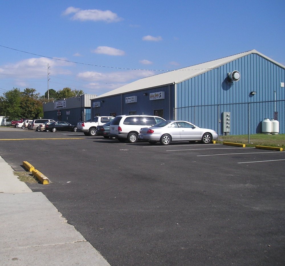

Lee,
The single biggest PITA is going to be laying up the insulation the same time you place the PBR if you decide to DIY. I watched my contractor struggle with it and he's been doing it for years. Don't do your slab. Have the pros do it. Make sure the erector (if you choose to hire one) uses boca code specs and local specs as well. Mine didn't and he had to go back and insulate the inside walls again. This was retail space and not a shop or barn but the codes are pretty much the same and the building was 40' x 80'. There's alot more I could share and I will as the thread developes and I feel my input is relevent. Picture is attached. This project actually was 250K when it was done.
Tom K
