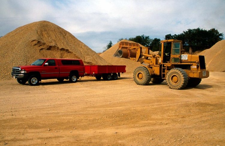

I have a Dandy Dump made in Tennesee. It is 12 x 6 feet. I routinely haul 3 yards of gravel with no problem. This trailer has the bed over the wheels so it dumps higher. It would require steeper ramps though. I don't use ramps since I have another trailer for that.
If you want to spread gravel make sure it has a dual acting tailgate. My tail gate swings open and locks to the side to open up the trailer completely in the rear. When the gate is closed a and locked in place it can swing open (hinged at top) for dumping. It also came with chains to limit the swing travel for spreading. It spreads gravel so good there is little tractor work when done.
