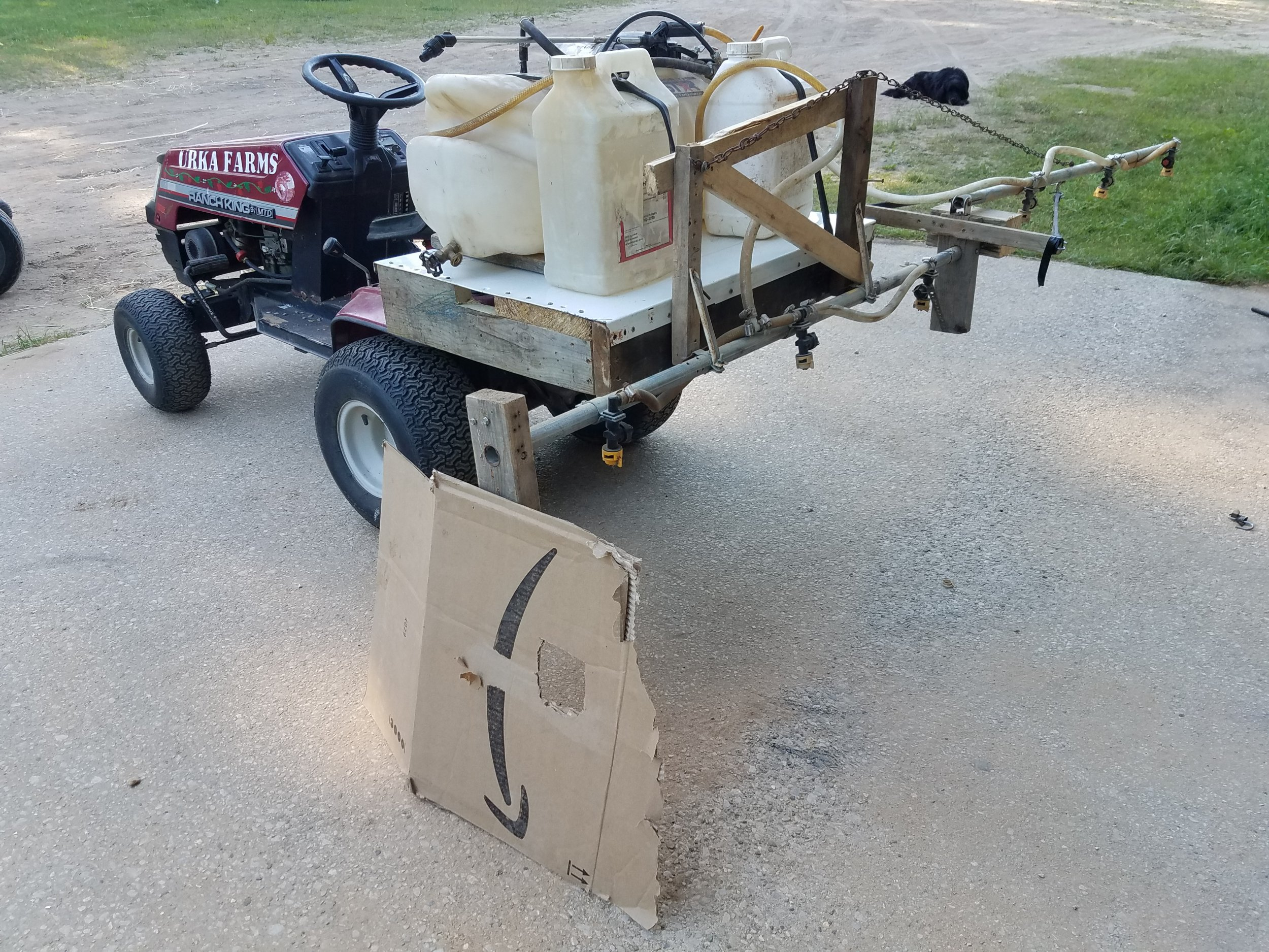

Took me a while to get my mind around the rates. Limited pump.
   / Looking for build ideas for a "Zero Drift Herbicide Applicator"
#9
Took me a while to get my mind around the rates. Limited pump. View attachment 704803View attachment 704804.
You've put a lot of gear on the back of that little tractor!! Is the front end jumping up when you start out or hit bumps? Anyway, it looks like you are way ahead of me with your implement. I'm hoping to keep mine simple as possible. I'll begin with gravity transfer with the supply at about seat height like yours but the drip line about 3" from the target/ ground level. The holes in my drip line are 1/16". If that proves to be less than sufficient, I'll make 'em bigger. I'm almost ready to try it out with just water to see if my system works and what the application rate looks like at slow speed. My drip line is a garden hose five feet long with the holes drilled approximately 5/16th" spacing. I'll start by filling the reservoir (5 imperial gallon pail) and timing the flow and comparing the flow when full and near empty. My guess is I'll be varying my ground speed as the reservoir empties.
   / Looking for build ideas for a "Zero Drift Herbicide Applicator" #10
I been spraying a while but some simple concepts escape me and I had the tech stop by to get my mind wound around this due to volume. I added a bypass to be able to regulate pressure. I figured it out abs still did it wrong. Basically a positive displacement pump.
Doesnt appear to have hurt.
