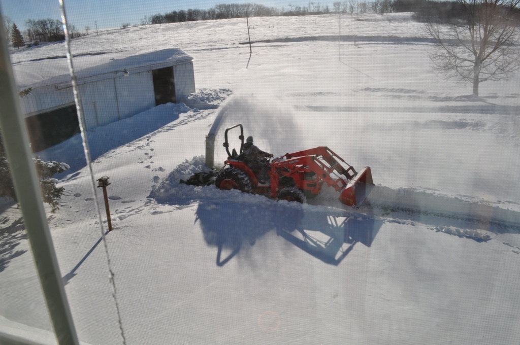

For the little bit that your going to be doing a rear mount is the way to go.
3000 feet may seem like a lot when using a walk behind but a rear mount blower will wade through massive amounts of snow in very little time.
