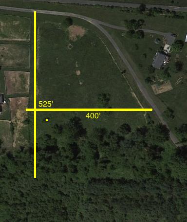

Just bought a 4 acre lot and need a tractor/ mower. I currently own a Simplicity Boradmoor and LOVE the quality cut and striping, but not enough tractor for this lot. This is very hilly and would not want to attempt on a Zero turn or the Broadmoor. Lot is very long and not alot of obstacles (see pic). Here are my main uses/wants, in order to neediness:
1. quality mower with striping ability.
2. Good on hills and side slopes.
3. 4x4
4. Ability to tow trailer with fire wood.
5. Lift bucket/ slip scoop.
6. Snow plowing
7. fuel consumption
Its about 7-8 miles of mowing per cut.
My top two choices: (at this point)
New Simplicity Legacy XL with 60" fab deck $11k
Used Steiner 430 4x4 with 60" finish deck and slip scoop. <$10k
Any opinion would be appreciated.
Thx.

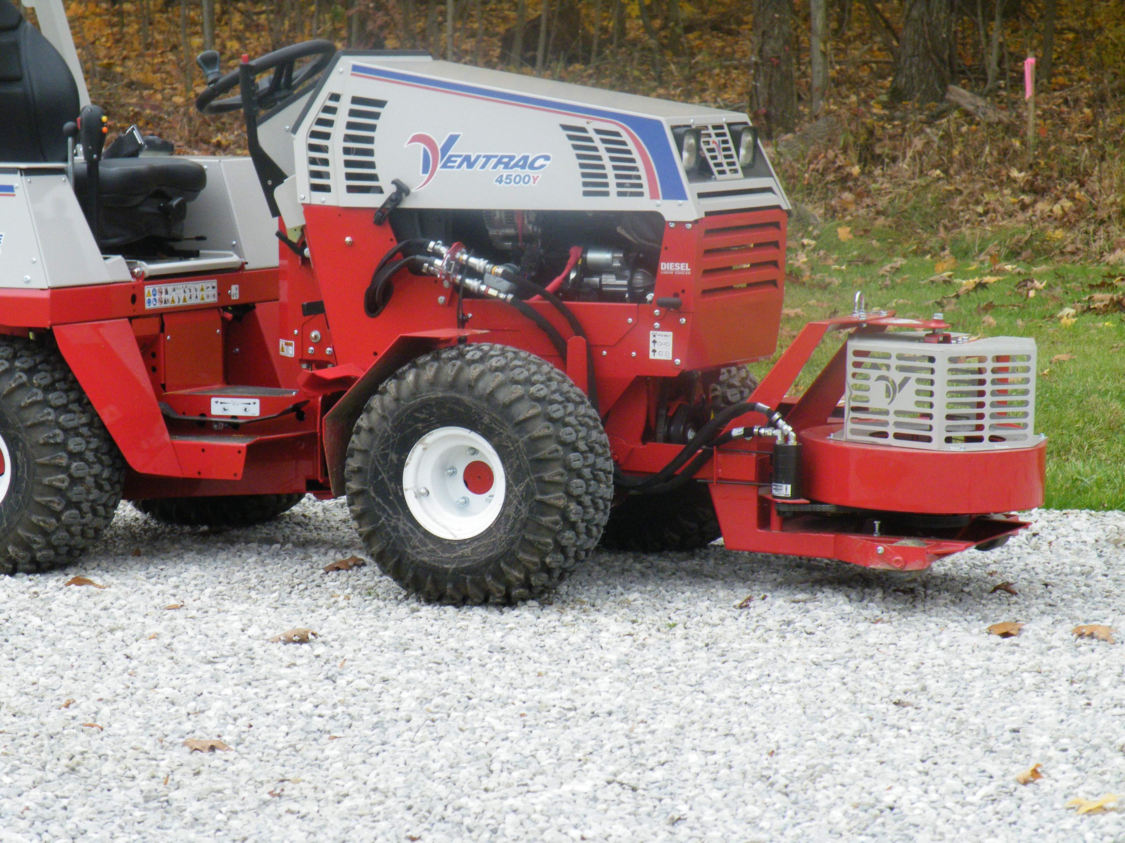

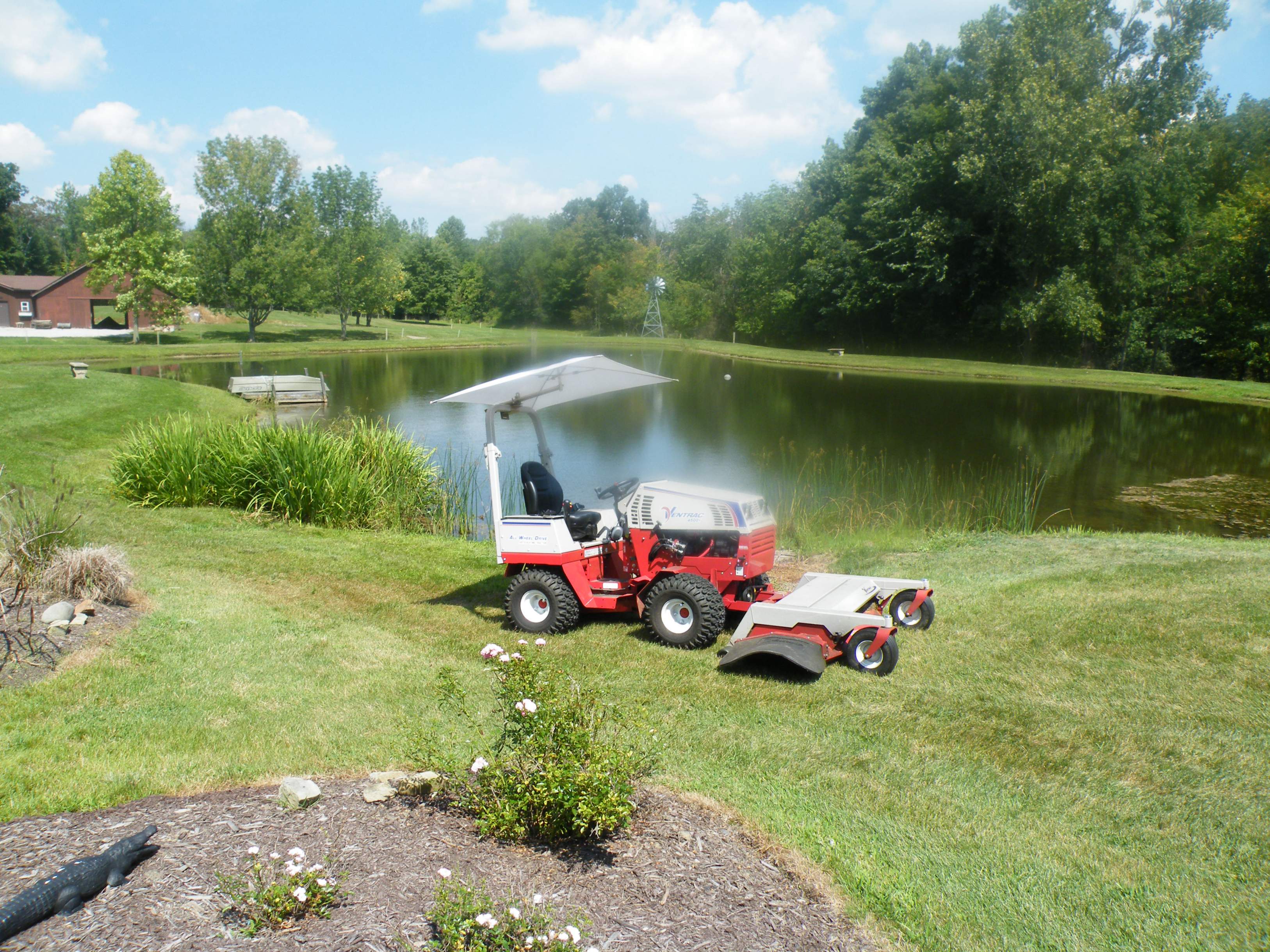

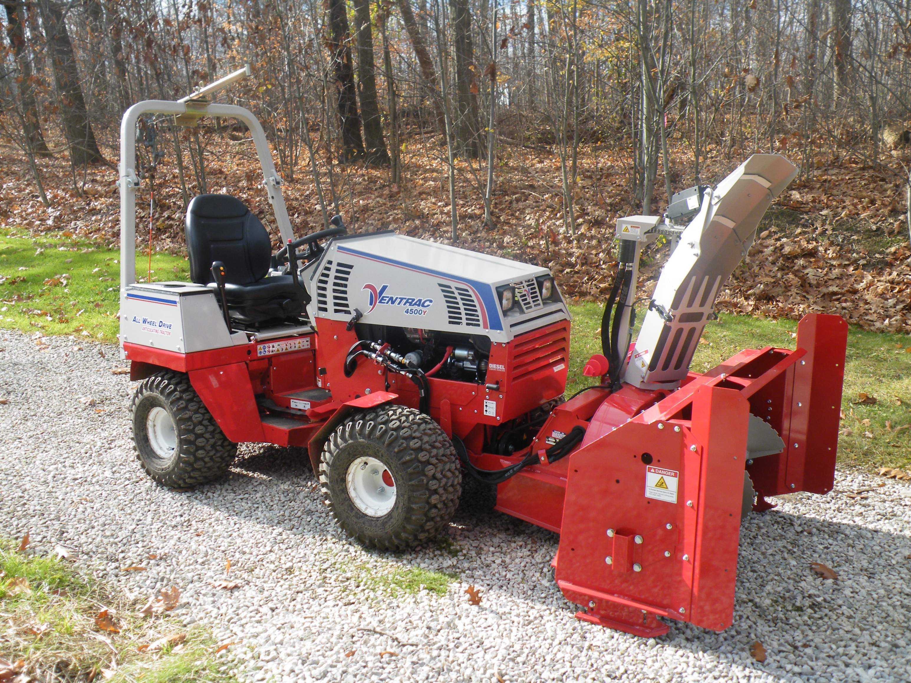

If your doing hills you need a steiner or ventrac. all are full time 4 wheel drive. Mine has striping rollers.

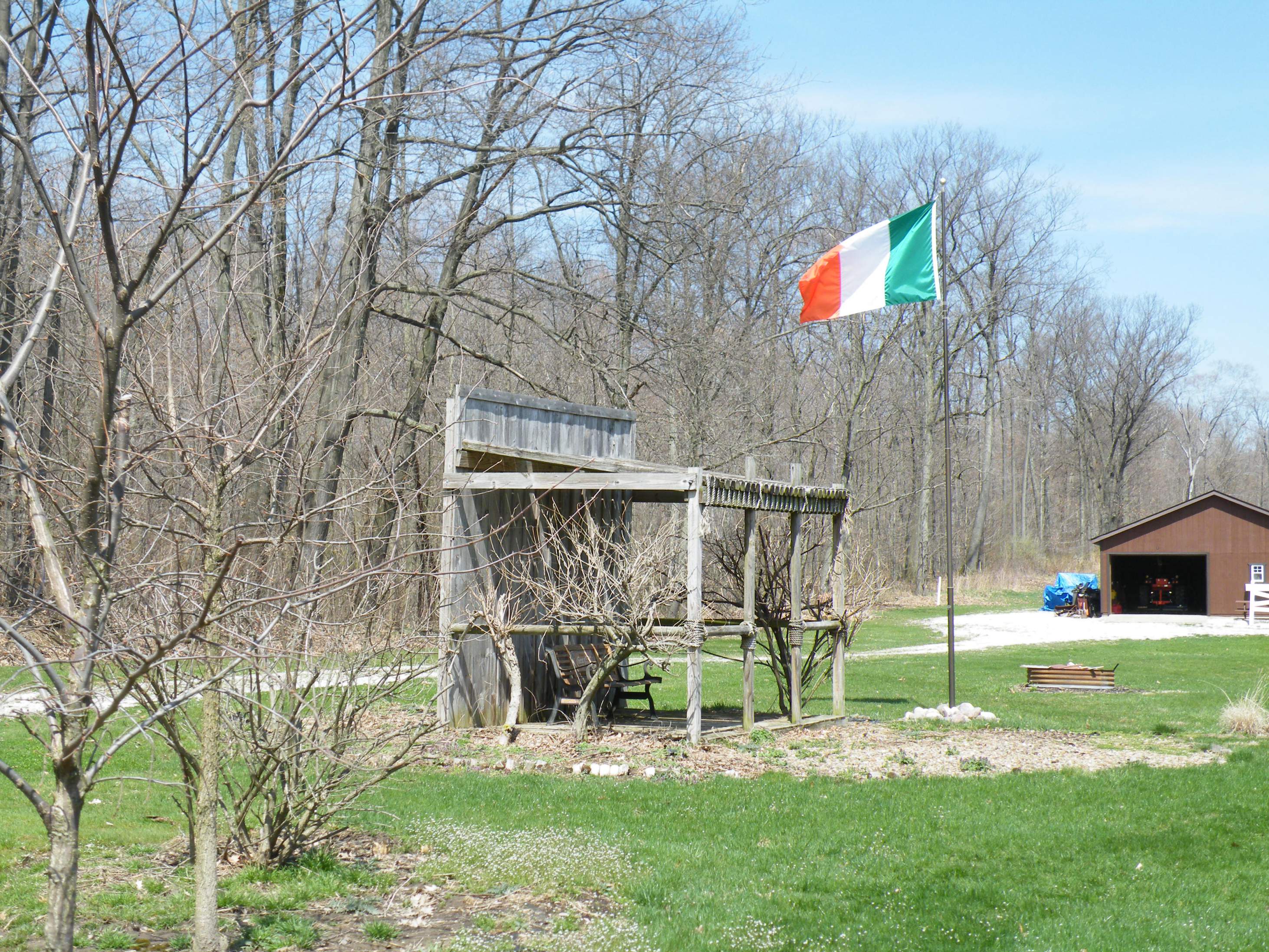

btw murphy 1244 looks like you have a very nice place & equip to keep it up

your pond & setting caught my eye. went to college in mt vernon area (ohio) but have long since made the ozark mt. my home. thankful for all the water on the mt top. lots of wood duck.....sorry to divert the thread, one luxury on this forum. HNY to everyone here:)
