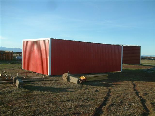

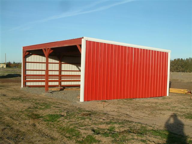

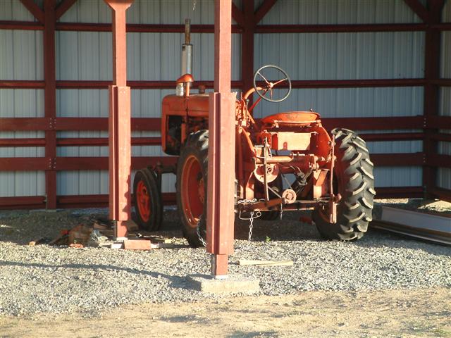

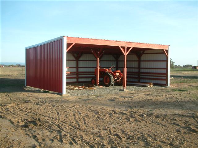

I work alone and built this 20 x 28 ft equipment storage shed a few years ago.
DSCF0090 (Small).JPGDSCF0094 (Small).JPGDSCF0097 (Small).JPGDSCF0099 (Small).JPG
-two 14 x 20 ft bays
- 10 ft high roof in front, 9ft in rear
- 4x6 pt posts set in 18"x18"x18" footings, Simpson post bases
- doubled 2x12 beams
- 4x4 knee braces
- 2x8 joists
- 2x4 girts and purlins
- 29 ga R-panel sheet steel sides and roof
Cost: around $2800 for materials.
