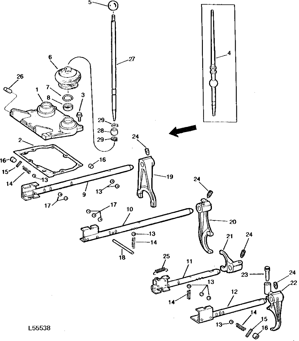

I have run into a new problem yesterday though with the Deere. It locked up in gear. The hi low shifter locked in low range and stick wont move. Never had this problem before, was hauling out some logs and had this issue. have to work on it today and figure out why. Too many logs left in the woods to leave in the shed.

Does gearshift lever move but trans remain in gear? If so the welded tab on end of shift rail may have broken off as I've seen this happen in the past. One needs to remove gearshift cover to be able to determine problem and possibly weld tab back on. Power steering valve could be added from a salvage tractor.

Tx Jim shifter does not move other than a slight side to side movement. I tried rocking it and pulling upward on stick and got nowhere. next step is to pull top cover off transmission. Talked to my mechanic brother today and he says it happened about 10 years ago, and he pulled cover and was able to unstick it. I am going to check the tab on the shifter rails to see if that is it. we have had some trouble in past with going into park. I found a couple of threads this morning with the same problem and noticed you had given advice on those also. Thank you for your wisdom. I am searching for a service manual now to get a parts view of transmission. Yes I may look for A POWER STEERING SETUP FOR THIS TRACTOR. I still look at new tractors in same HP range but hard to beat this ole girl she has been a good one.

Back when I sold 820's when they were new we hardly ever had any warranty issues with them. Just sell them & forget them.
   / Looking for advice on John Deere German 820 tractor loader #10
IIRC the tab that breaks is on shaft #11 of the drawing TxJim posted.
For a service manual, if you can't locate one for an 820, try 830. If you only need trans info, 1020, 1520, 2020, 1530, 2030, 2630. I am sure there are more in the 40 series too, 2040, 2240, 2440. TxJim can probably add a few more.
Mine was broke in my 2030. I had to split the tractor to replace it. I never considered welding the broken part back on, but did not know where it was (found it in the bottom of the trans). Since the tractor was split and I had the new shaft, it went in.
