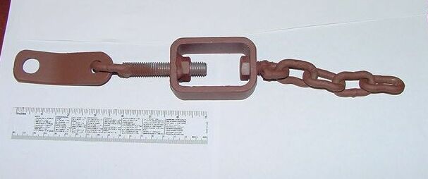

I am looking for some strong, heavy duty sway chains for my YM1300D they need to be rather short as the tractor and the 3point hitch is relatively small. The chains tha came with the 3 point hitch conversion are not adjustable and it is a pain to change the length for different implements.

Also I have looked for turnbuckles but cannot find any short enough and strong enough.

I couldn't find turnbuckles heavy enough and short enough, so I made my own - kind of...
Actually they are more like half-turnbuckles, using a piece of rectangular 1/4" wall tubing and a couple of bolts and a nut. I attached a picture. Only one side is actually adjustable, the other side is just a bolt through a hole welded to a piece of chain. This way I didn't have to worry about left handed threads. The other side has threads and a nut welded inside for extra threads, with a piece of all thread welded to a piece of chain.

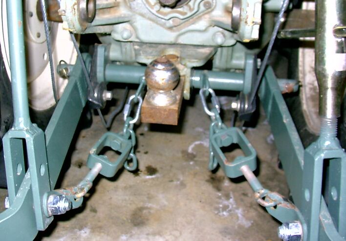

Here's another shot of one before final paint. A bit closer up.
