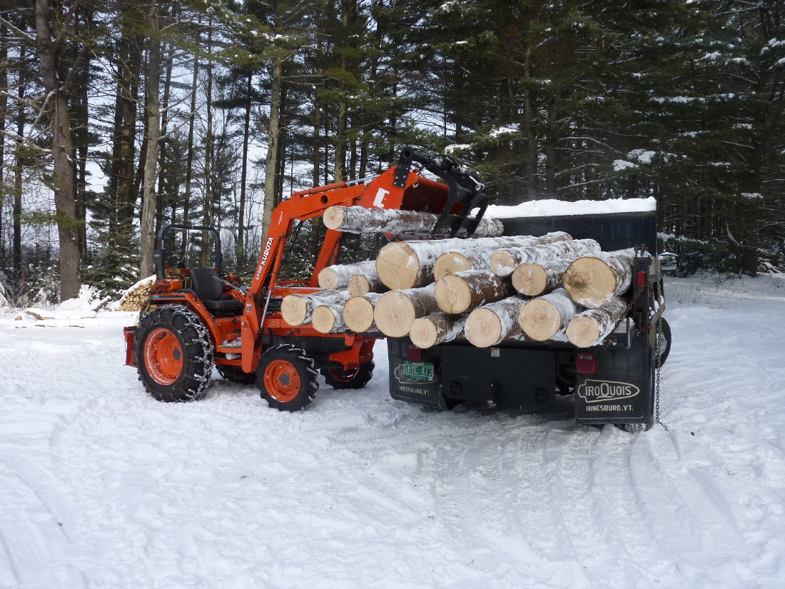

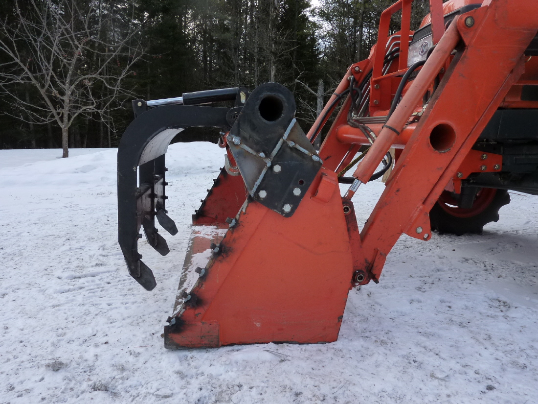

I have found my thumb type grapple extremely useful and productive. The only advise I can give is to try to find one that has some curvature to it. One that does not close down flat. The side edges of your bucket act as one side of the grapple while the thumb or tines act as the other. When the grapple is closed you want some room in there to hold stuff and if you are trying to grab something fat you want to get on either side as much as possible. If you try to grab with a wide open "V" rather than a "U" stuff slips out easier. A lot has to do with the way you mount it. Mine was very good when I first got it but I changed the mounting position and added more curvature over the years to make it even better. You can see the changes I made in the picture to give you an idea what I am telling you to look for. Also adding a tooth bar is another big improvement in being able to grab stuff. It stops stuff like logs from just sliding down the bucket edges.
Now don't get me wrong. My grapple was wonderful before I added the tooth bar and made the changes. I used it for years and loved it. I am just trying to show you what to look for in comparing units and show you that mounting position is important.
Then I added the tooth bar

Gordon, do you like the studs on the bucket edge, are there any drawbacks? Never seen them before, knee jerk is I may add them to my bucket.
Thanks,
Neil
   / Looking for add on grapple for my 54 inch light duty bucket. #6
Thanks,
Neil
That's the first time I've saw that. Curious to hear the response as to their usefulness. I use a homemade Grapple on a Bobcat bucket. I can't say I've ever wished the bucket edge had teeth. But I'm always open to modifications and improvements. :)

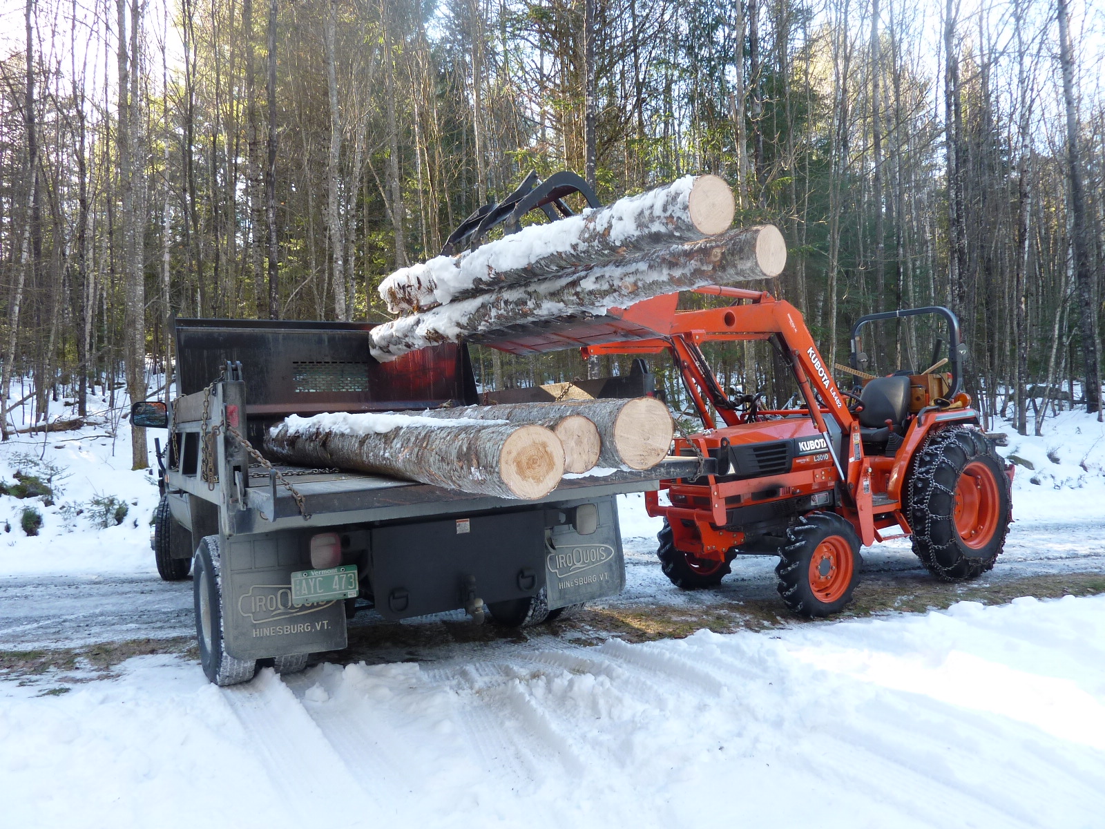

The thing I do most is load my truck with logs. It is the main reason I bought it.
Frozen ice covered logs or just wet logs can be very slippery. The first change I made was to put those little teeth on the bucket edge and the grapple tines so I could bite through the ice or slippery bark and get a good grip. The teeth are just short pieces of 1/2" re-bar or rod welded on like little round teeth. Makes a world of difference in getting a good grip and keeping a big log from sliding out when you close down on it. They also help hold more brush.
Then when I added the tooth bar it became easy to do two at a time.

My grapple tines/claws have teeth on them. Just never thought I needed them on the bucket edge. I'll give that some thought. :)
Once my tines clamp over an object and press it against the bucket teeth, it ain't goin nowhere. :)
