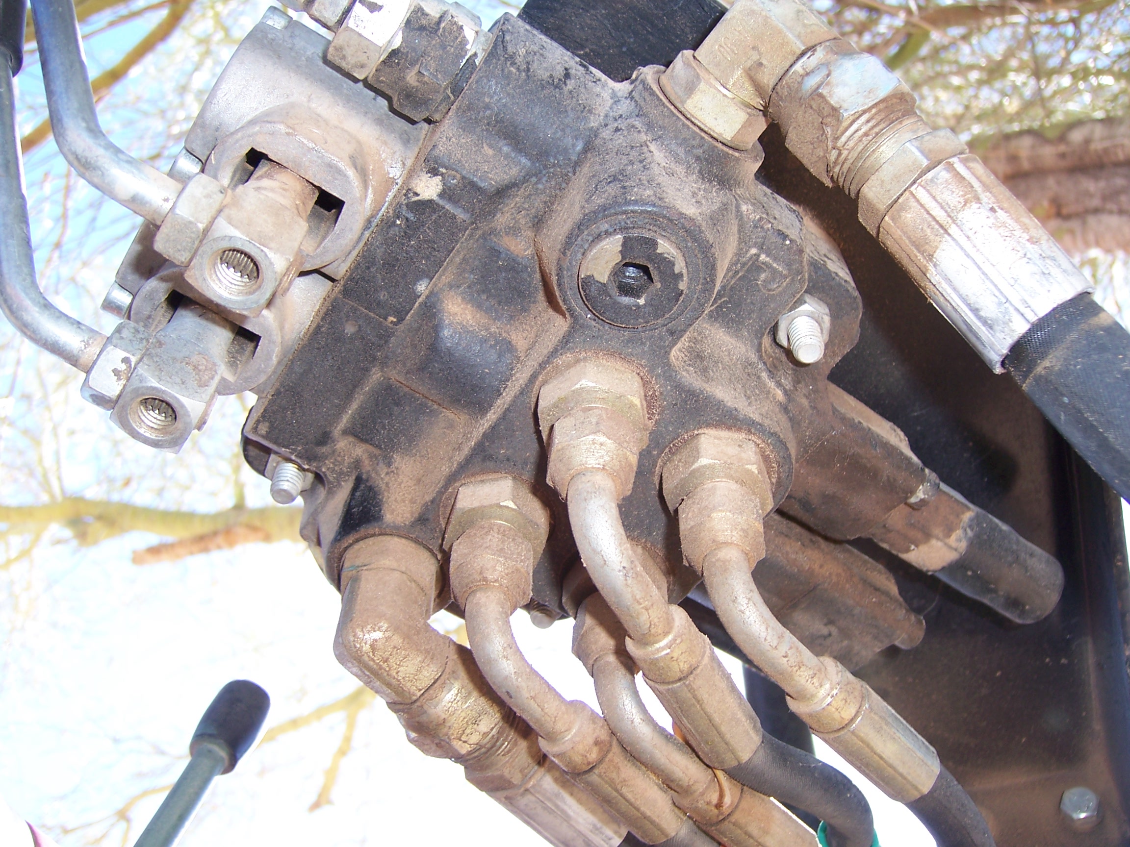

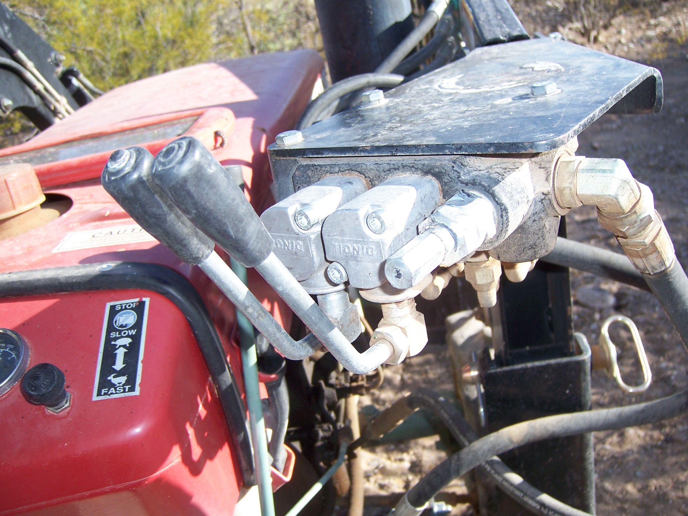

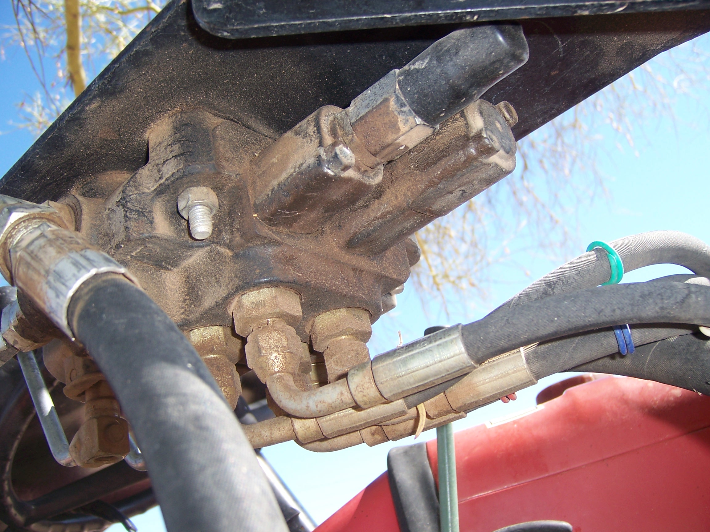

Hello All,
I'm new to this forum and from scanning though, I see that there's a wealth of information here . . . fantastic! I have a Yanmar 1500D and my hydraulic control valve for the front loader appears to be defective. I've had problems with it before, cleaned it out and it worked fine for awhile, but now I'd like to replace the whole valve body. Anyone know where I can purchase this item? I prefer a new one, however a good working refurbished or re-built one would be okay. Many thanks to all.

   / Looking for a Replacement Part - Dinoil Control Valve #2
I bought a Prince LVT1GB5AB1 ($230 from Amazon) for the same repair.
This valve has Float (essential for back-dragging) but not Regeneration (accelerated dump feature, $100 more).
Here's a thread where I asked all the novice questions before making this repair. Summary of that thread: Just buy this valve.
Thank you so much for the great answer . . . and so quickly! Without further ado, I went ahead and ordered one through Amazon per your recommendation. I don't know when you bought yours but the price certainly hasn't changed much. It was $232.75; can't beat that. Many thanks again!
