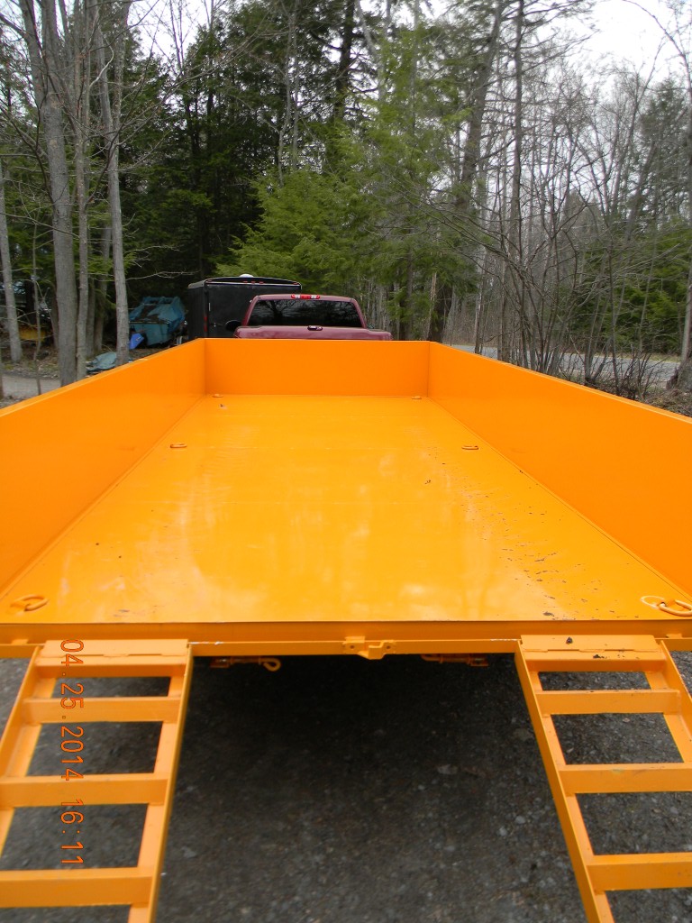

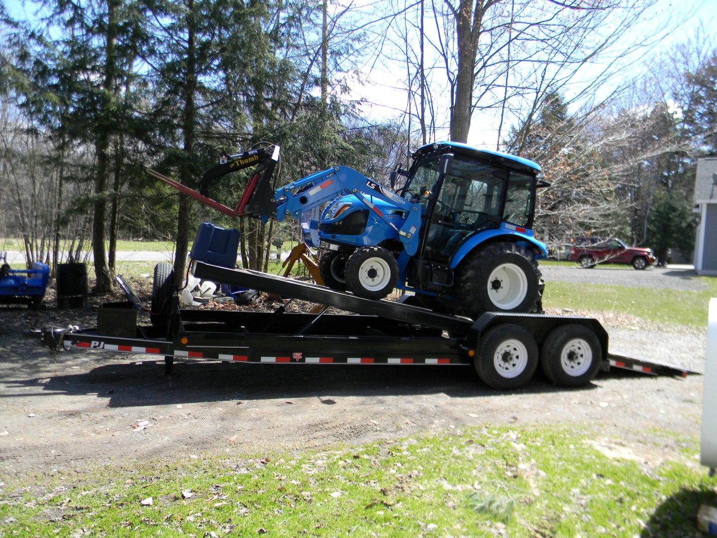

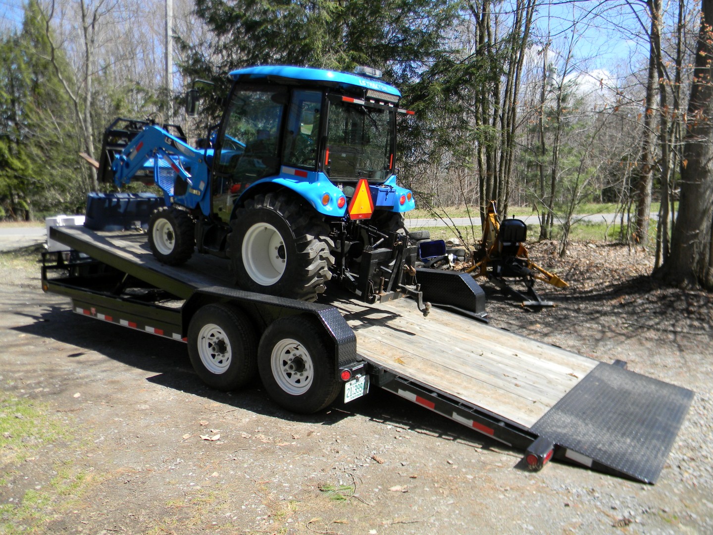

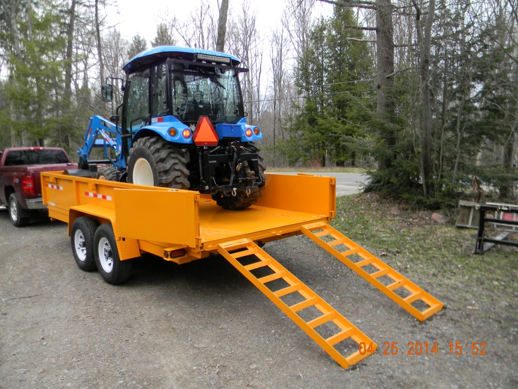

I have a 22' (actual bed length 23'9") PJ 14K full tilt bed. Just a matter of a few seconds to tilt, no ramps to mess with. Mainly tow with a 1/2T pickup but have a bigger truck to tow bigger loads. I also have a 16' dump trailer with heavy steel ramps. The PJ is much easier to use for loading the tractor and chaining down. Yes, a tilt bed costs and weighs more than a ramp trailer but once you pass 60 you look for easier ways to do things.

Do you ever worry about the tractor rolling back while the trailer is tilted? Heard about, but did not see, a tractor that rolled back due to brake not tight enough. No damage and nobody hurt.
   / Looking for a New Trailer #5
There are a couple other threads where some LS (and other brand) tractors parking brakes do not hold when on an angle. The pic I posted of my tractor on the PJ shows the tractor parked and running in neutral with just the P/brake on holding it in place. I have no doubt if I parked mine in gear, loader down, brake on, that it would stay put. Some tilt trailers also come with a remote control so you could drive on then tilt the trailer level without leaving the tractor. I've been thinking of buying an aftermarket remote kit for mine.
