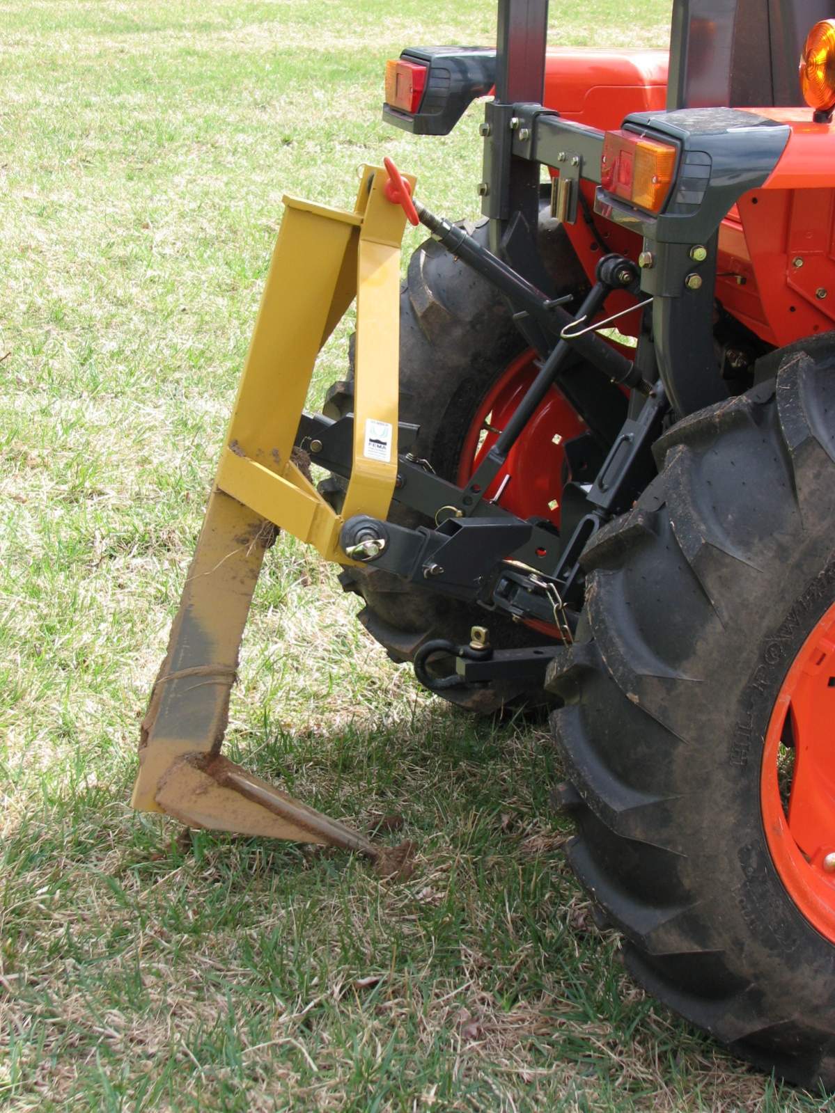

I use that very same blade for a potato plow on this subsoiler:
It works okay bolted directly to the subsoiler, but the angle is a little shallow. The last time I used it I tried putting a 3/4" stack of washers between the aft bolt holes, between the plow and frame, to give it a steeper angle. This worked much better. It worked so well that I plan to make a wedge shaped adapter for future plow work.
I still need to make a "fuzed" top link pin so it will shear out before I rip something off the back of my tractor (or wind up riding the hood) next time I hit a big root. It stops in a real hurry.
-Jim

As mentioned the cutting angle of the middlebuster, and subsoiler sold at TSC, etc. are different as are the depths they are capable of working. The subsoiler will go much deeper, but it looks like you would need a fair sized tractor to lift it out of the ground. If I remember right the pins were darn near 25" high from the cutting tip.
(in my best Ed McMann voice) Sir, yes, you are correct, yes!
I had to pin the top link to the bottom hole on the transmission bracket and shorten the top link to get enough ground/blade clearance to drive across our field without pulling up divots.
