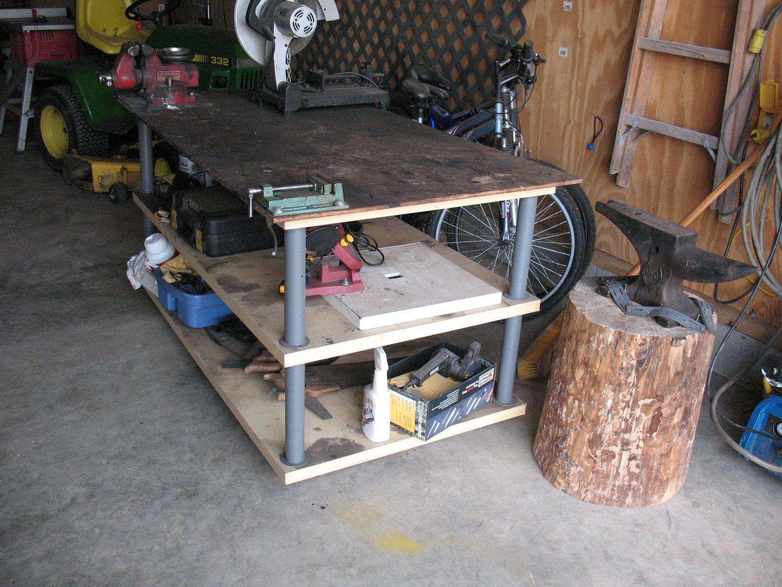

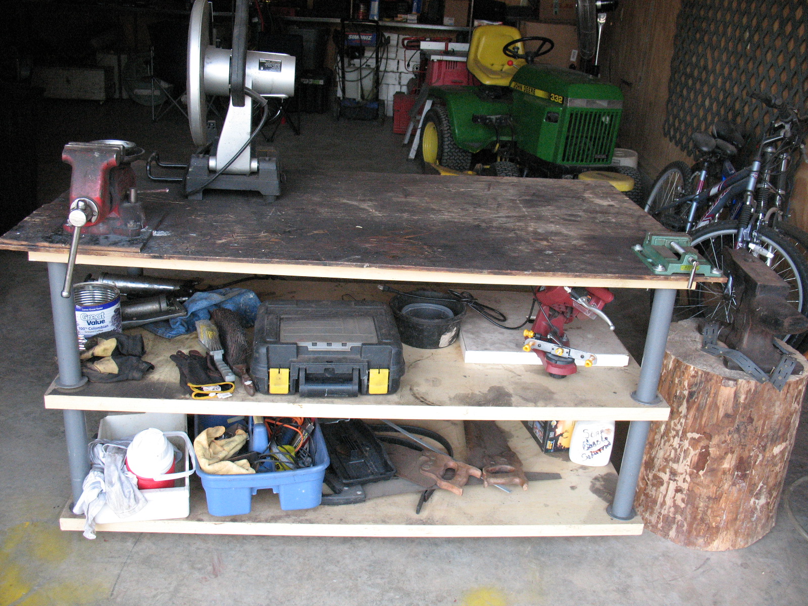

IMG_1183.JPGIMG_1184.JPGThe angle iron frame would be just as good as the tubing if you put the cross bracing in. If you have room for a larger table, I would go bigger. Mine is 36"x64 x 33" tall and gets too small sometimes with just laying all the tools needed for a project and has limited room for work. I also have two shelves on mine with solid surface which I think would be better than expanded metal so you can put small objects on it without them falling thru. The casters swivel on all 4 legs for easier maneuvering. I haven't found a need to lock them when working as it doesn't move that easily but can be moved in all directions with the 4 swivel casters which is much better than trying to drive it like a car to get it out of the way.
   / Looking for a little guidance on a welding table #8
View attachment 304771View attachment 304772The angle iron frame would be just as good as the tubing if you put the cross bracing in. If you have room for a larger table, I would go bigger. Mine is 36"x64 x 33" tall and gets too small sometimes with just laying all the tools needed for a project and has limited room for work. I also have two shelves on mine with solid surface which I think would be better than expanded metal so you can put small objects on it without them falling thru. The casters swivel on all 4 legs for easier maneuvering. I haven't found a need to lock them when working as it doesn't move that easily but can be moved in all directions with the 4 swivel casters which is much better than trying to drive it like a car to get it out of the way.
As you can see from the photos, my table has a 1/2" protective plywood top mounted to the top of the 1.5" thick formica covered particle board slabs. I put a second layer under the vise where I sometimes do oxy-acetylene cutting which is getting a bit burned but still good. I found this table at a going out of business sale for $50 and thought it would be good till I built a steel table. It is 3 years old and works fine for my work so far so I haven't even thought of building a steel table. As you can see, I have an anvil for pounding on and if that isn't getting the job done, I have 2 pieces of railroad track on top of my 8 ft. disc that I use for straightening longer rods and such with my 16# sledge hammer. Up until recently I keep the anvil on the table till I got the piece of log from a dead tree we took down last summer. The table is heavy enough and sturdy enough to take a pretty good pounding without damage.
