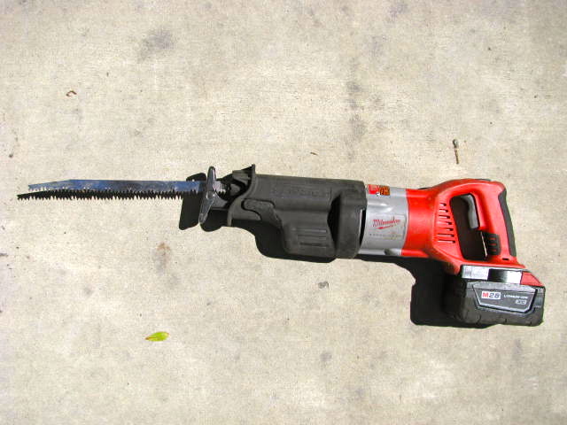

For limb work a battery powered reciprocating saw is superior to a chainsaw.

   / Looking for a lightweight limbcutting saw... #7
LOL. Superior in what way?
Sawzall is not even remotely close to being a replacement for a limbing saw IMO. Would be nothing but a waste of time.

Limbing is a fairly wide category.
Since this is a chainsaw thread I have to say I have a Stihl 028 AV Super with a 24" bar. Have to own a decent size saw for credibility in discussing more sensible saws. :D
I have a razor sharp axe, it has its benefits in some situations, but I don't use it often.
1/2" limb or 3"?
Cutting "at the trunk" or "away from the trunk"
Cutting 5 limbs or 300?
A battery powered recip saw could be the best choice of tool at the top of a ladder. I don't enjoy pulling starter ropes while on a ladder, or up in a tree. Squeezing a trigger has its benefits. If a chainsaw cuts a limb in 3 seconds vs 20 seconds with a recip, sometimes in the overal scheme of things; the "safer" unit is prudent use of "17 seconds". My Stihl mS201 (high performance pro unit $649) could easily take 17 seconds just to get it started.
