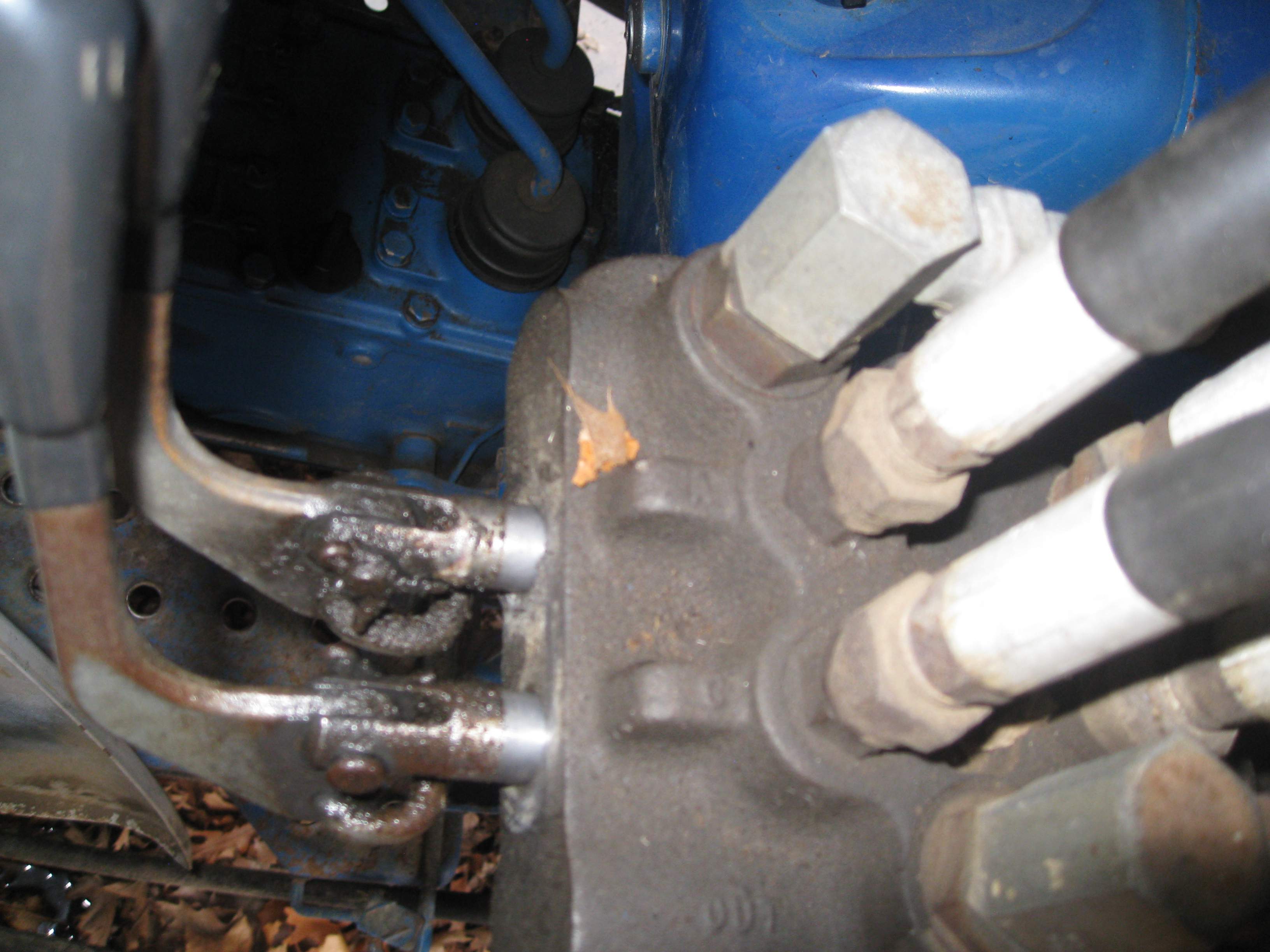

I want to change out the old control levers for my FEL, looking for the joystick kind. Was wondering what would work best for my ford 1900. Here is what i have now. Any suggestions?

what is the pb adapter for and where does it go? Thanks
   / Looking for a joystick for my ford 1900 for the FEL #4
The PB adapter is required to pass all pump fluid downstream except the fluid used by the cyl, which will exit the OUT port.
It screws in the PB port. A hose will connect from the PB adapter to the IN port of the next valve.
Could be a remote valve or the 3pt input.
